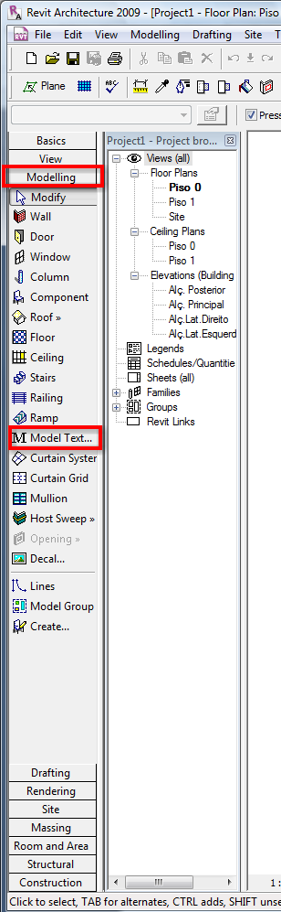

the idea about exporting and importing is great. I have only one problem with that- I can get the grid lines, but I can't get the text- in Revit it just disappears. Any suggestions what to do?
And the other thing would be-  where can I find a 3D text in Revit?

3D text...

I guess then 3D text- Model Text is ony in Revit Architecture, because in Structure by modelling tab there isn't...
Ok, let's say the problem about 3D text in Revit is solved, but does anyone know how to get the text from imported cad drawing- dwg? (In my case, it wont show the grid line letters and numbers)

Just look around a bit more next time - Model Text in Revit Structure is in the Architectural Tab.
