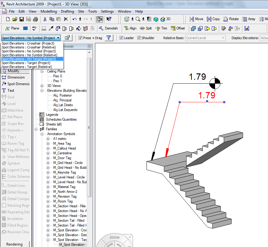

Is there a way to create a spot elevation family type without the target? I am refering to the spot elevation symbol you get when you go to Drafting / Spot Elevation.

You have already that kind of "Spot Elevation", with or Without "Target"...

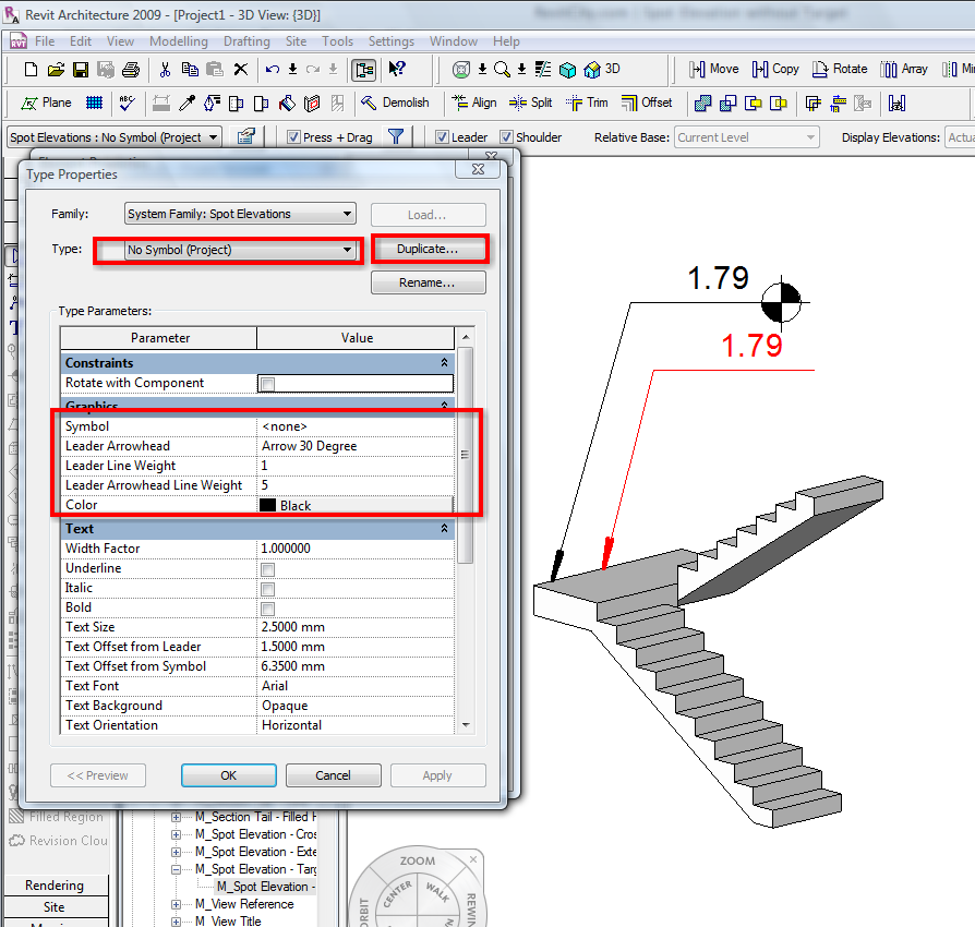

Thanks all... Some simple family types have gone by the way of successive purges. I knew it was a simple thing. Under the type properties of the Spot Elevation / Graphics / Symbol / none. I appreciate the help!
