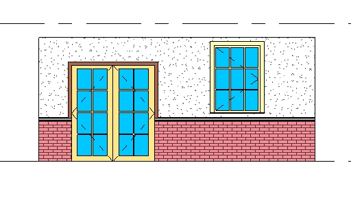

I've searched some older threads but can't find a resolution.  I have a stacked wall with a brick wainscot on the bottom and a plaster wall on top.  The brick wainscot on the bottom covers the trim at the bottom of the door.  Please help.  I'm using Revit 2009.  I've attached a jpeg as well as the revit file.

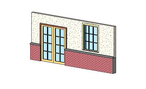

Here is a clearer view.

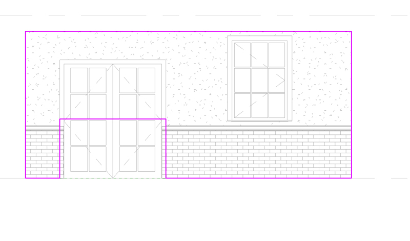

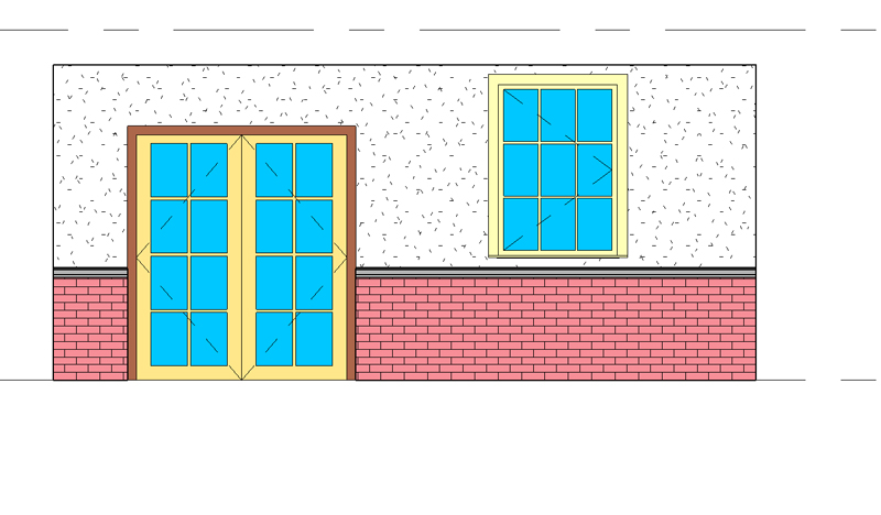

Edit the wall profile, but do not trace around your entire door frame__ just the wainscot portion.
see attached, right?

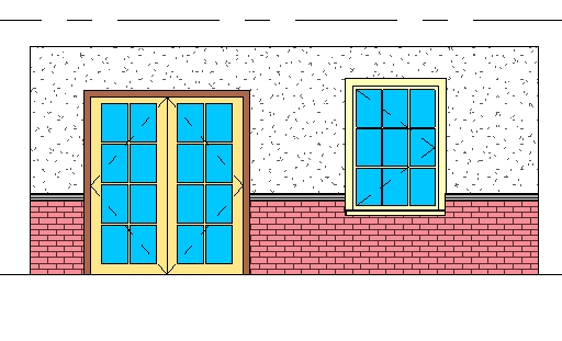

Thanks RevirComponents!  So I have to do that for each door and window?

I guess if you have to do it for each door and window, it can still be done with the same Edit Profile.  It even worked with the window.....I just put a full rectangle in Edit Profile.
Thanks RevitComponents!
