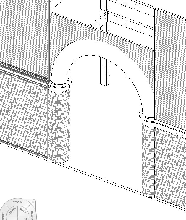

What would it take for me to create this kind of effect? I want to make that arch made of stone. To create it I used modeling, create, door, solid form sweep, loaded my own profile (simple, round).
Is there a way I can make that arch made of stone? Also is this the best way to do it? I appreciate any advidce. Thanks

You will have to use a drafting pattern to achieve this, so you may have to change the model pattern to a drafting pattern and adjust the size to suit.  The material can then align to the element.  The rendering should also align.
