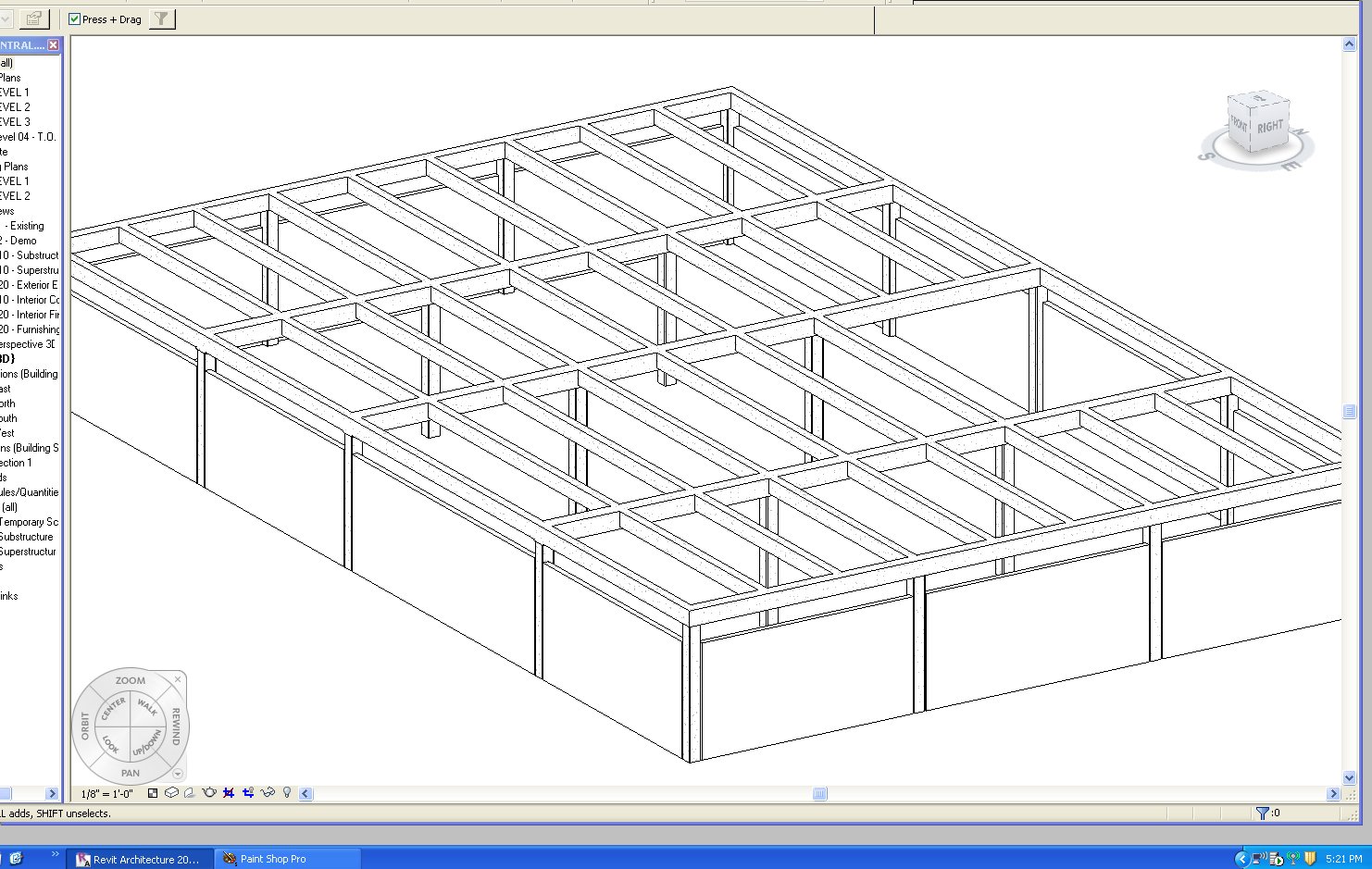

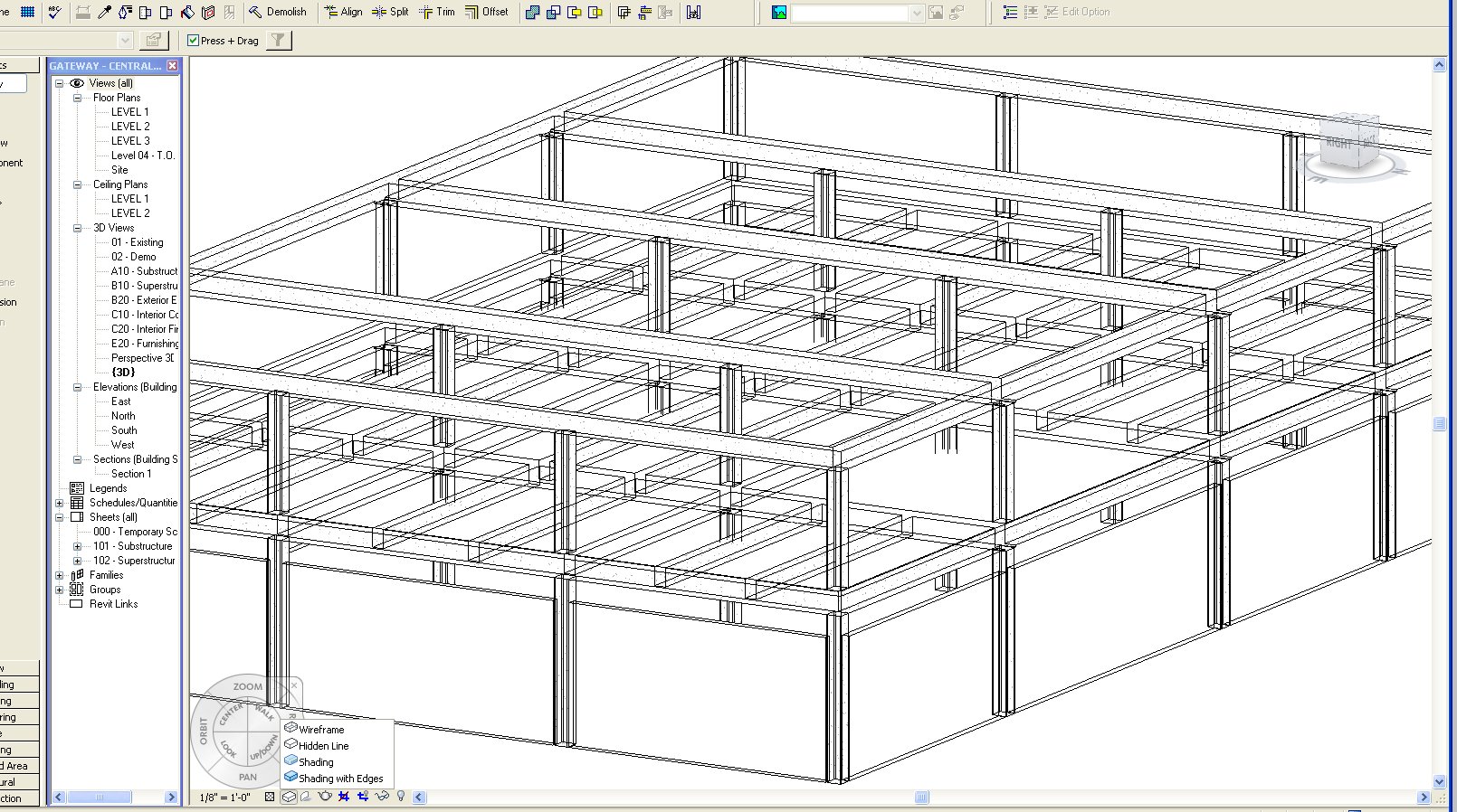

These lines showed up after I added my second story structure> Video/Graphics problems or operator error? Its not wire frame, it is set on hidden line.

This is typically the result of a corrupt view.  Delete it and generate a new {3D} view

Thanks that was an accident. It worked! Thanks for the help!
