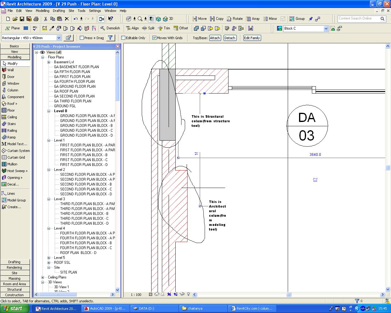

hi all, i am using revit 09,                            When i placed column in my revit its not joining/cut the wall! Can any one please help to resolve this issue?Thanks in advance

If you use the architectural rather than the structural column it should clean up with the wall.

Actually i copied structural column from old project and its working fine (i can do join geometry with walls) but some how my beams not doing the same....................its troubling me lot

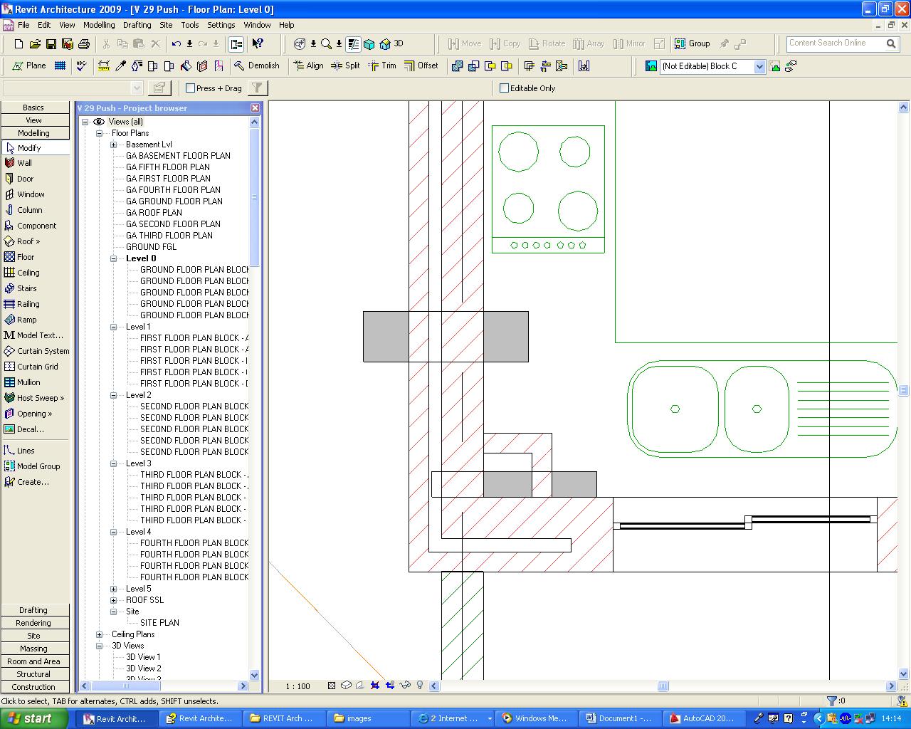

here is the default revit 2009 structural column..................may some experts can tell why this column not merging with walls???

here is the beam which is not merging with walls and slabs..................what should i do to merge this one??? this beam was perfectly working one year before in revit 2008!!!

hi all, its strange i just went to the family editor and reloaded my beam thats it ......its merging with walls now.....so problem solved
if any one has the same problem here is the beam for u
