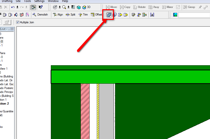

Hi
From an achitectual view I like that the deferent walls floors etc. are connected, so there are no dividing lines between them.
 Does anyone know if it's possible ?
 Thanks
Jorgensen
Sat, Mar 14, 2009 at 2:02:38 PM | No dividing lines on sections ?
Joined: Tue, May 22, 2007
5921 Posts
4 Stars: 205 Votes
Yeah, use the "Join Geometry" tool...

Wow that was simple - thanks Typhoon :-)
