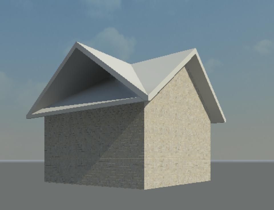

I want to have a double gable ended roof structure on a sqaure structure??????  What is teheasiest way to achive it???

jnordby
Joined: Tue, Mar 25, 2008
39 Posts
Like this but better.....

Like this???
Thu, Mar 12, 2009 at 3:41:01 PM | how to dreate a double gable ended roof on a square structure????
jnordby
39 Posts
YEs but all four sides look a like.....

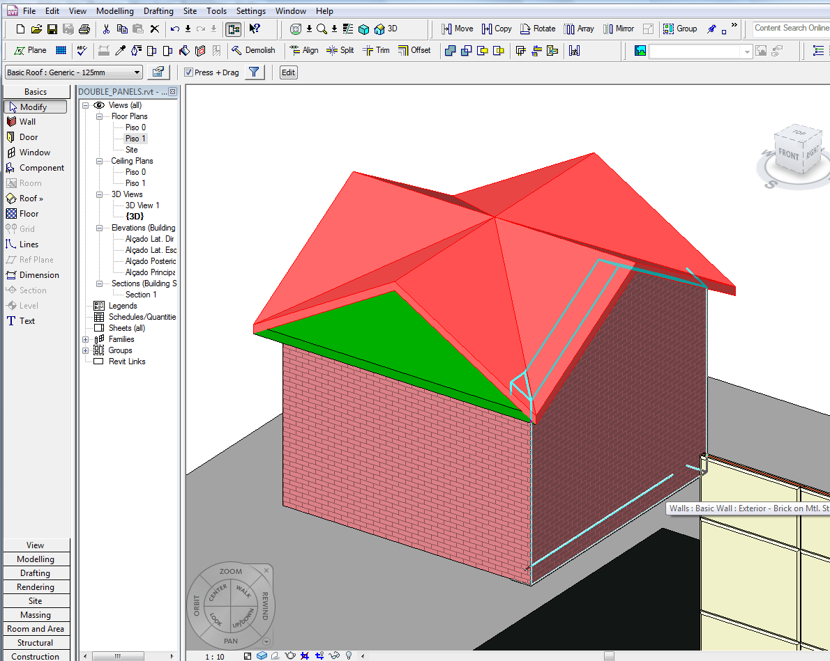

See the video: http://screencast.com/t/sO6awtHb1d

TY for the quick video. I did everything that you said but when it came time to finish the roof it gave me a error 1 message?????

says can't make footprint.....

Put a small value in the slope of every gables, if you put 30 use 15 then it works, finish the sketch, after this pick in the roof go to properties and change again the slope value to 25, 30, whatever. BTW, it's a square structure isn't????

I am using residential slopes not degree's???  I had 8/12 and then tried 3/12 and noting worked???? Yes it is square.

Did you split the lines in the middles of them???? Are the Slope arrows with the same slope value???

yes and yes   I tried over three to four times and always started from scratch......just how you showed in the clip.

Wierd.... you are doing something wrong.... I do this later with the Units in "feets and Fractional inches"....
