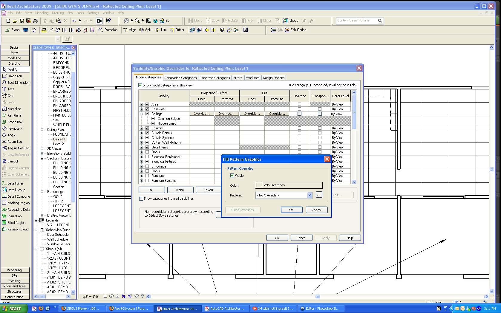

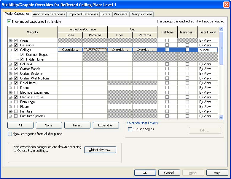

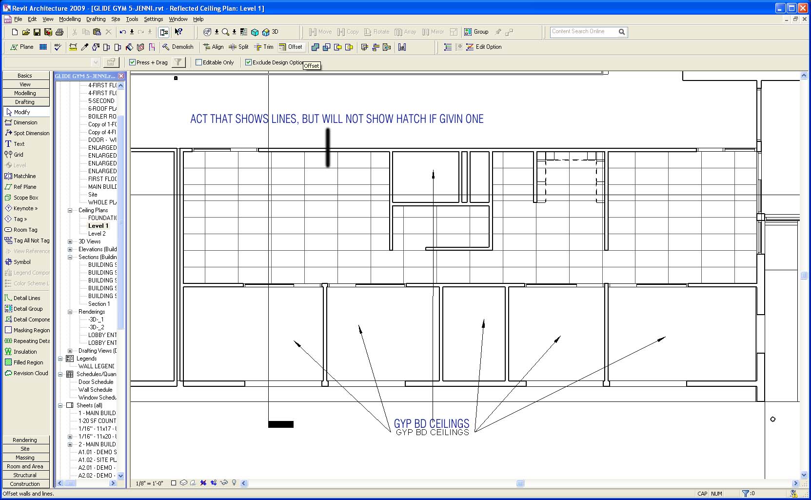

I gave my GYP ceiling a hatch pattern in the elemet prop's, but it won't show in the ceiling plan.  I have checked the VG's and it seems everything is turned to visable with no overrides (Ceiling, Projection/Surface - Pattern).  Is there another setting i'm missing so so that this will show?  If i override the ceiling it will hatch it, but it will not show by just changing the element properties.  I also have a ACT ceiling that shows the lines, but if i give it a hatch in the EP's it won't show.  I find it very strange and know it's got to be a simple thing.  Please Help!

I have assigned the hatch to the ceiling type in element properties and it won't show up in plan.  I have checked the VG's under the ceiling catigory and it's all visible and by catigory (no overrides).  I don't know what the problem is... I'm thinking there is another setting some where that I need to change.  It's very strange.  If i override in VG dialog the hatches show up, but then all ceiling types have the same hatch.  The hatch has worked on another project, there is just something I'm missing.

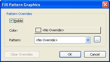

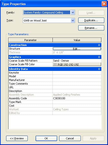

Here are my settings.  If you need me to post something else let me know.
54934_ceiling_plan_view.jpg54934_fill_pattern_graphics_from_VG.jpg54934_Type_Props_of_ceiling.jpg54934_VG_dialog_box.jpg54934_VG.jpg
Thu, Mar 12, 2009 at 7:00:30 AM | Hatch Pattern in GYP ceiling won't show
#14

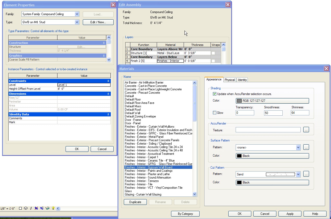

The GUI you show for the fill pattern is not the surface pattern.  It would be a cut pattern.  The surface pattern is controlled by editing the structure of the ceiling.  See attached.  My setting has no surface pattern but does have a fill pattern.
Thu, Mar 12, 2009 at 10:00:42 AM | Hatch Pattern in GYP ceiling won't show
#15
jennijenj3
Joined: Tue, Jan 20, 2009
35 Posts
Thanks!  I knew I was missing something.
