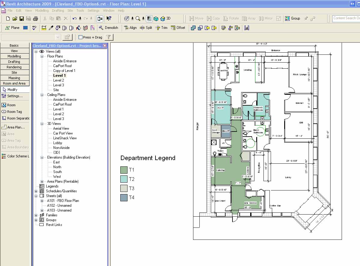

Is there a way i can change the colors of each department? I've attached a screen shot.  Is it possible to change T1 from green to yellow?
Also is there a way I can change the legend from department legend to a client or tenant legend?  I've been unable to change the name of the legend any advice?

Click on the legend and in the options bar a button will appear called "Edit Color Scheme"  Click that button.  This will open a dialog where you can click on the colors and change them as well as change the title.
