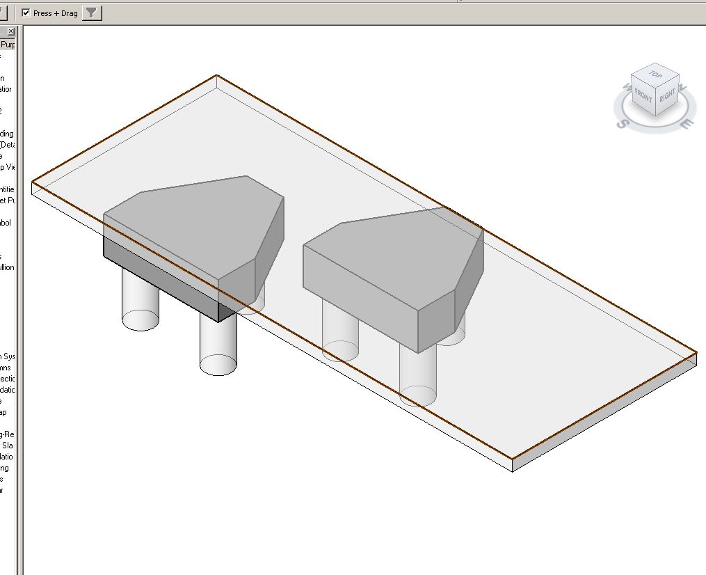

DaveF
Joined: Sun, Mar 26, 2006
83 Posts
Hmm...
Attached is an image I captured in shaded with edges mode.
I'd set the transparency thus: Settings>Materials>Graphics>Transparency Slider = 45%.
I did NOT set the 'Use Render Appearance for Shading' option.
This appears to contradict your statement, unless I'm missing something?
I'd like this appearance to be view specific.
When I create a 3d dwf, this appearance is transferred to the dwf.
