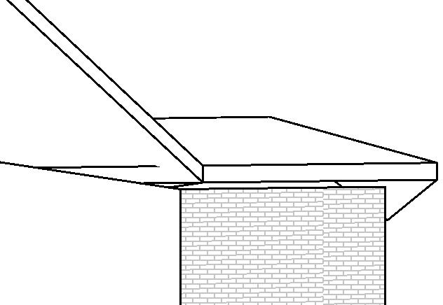

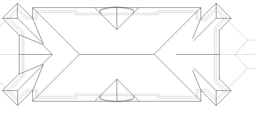

I previously Posted on how to get this roof to work (http://www.revitcity.com/forums.php?action=viewthread&thread_id=15288) and I thank those who replied.  Now I have a new one.  I'm using slope arrows to provide a clean gable.  The picture that shows nice gables has a joined roof system at the right.  Problem is that in isometric view you get the fascia overrun as shown.  Since this building is going to be rendered this is un-acceptable.  Problem becomes that when I do the slope arrows for the right gable, which worked fine for the left side (similiar situation) Revit totally brain farts and I get what is shown.  Not only does it not get what I intended for the right side, but it alters the left side gable and divides the two side gables.  Any ideas for the renegade Revit?

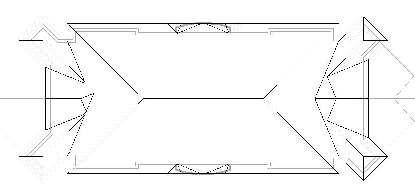

Do someting like this and use join roof...
 Hope it help...
