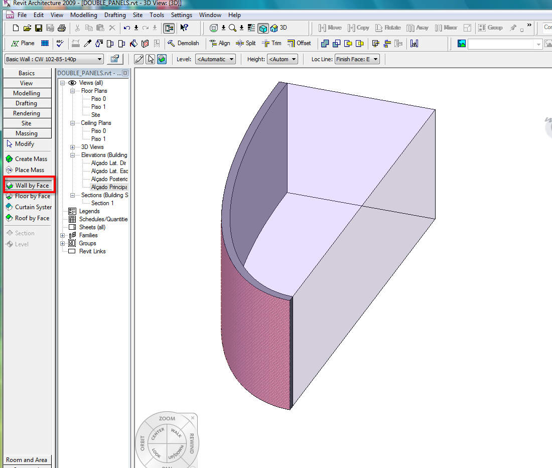

Hi, i'm quite new to Revit, but been working on Autocad for some time.
I have a project that i wanted to start using revit with, but i have 3 partial ellipse walls which i cannot create.
I have done a few searches for info but not having any luck.
Please advise me how i should do this.
Cheers
Craguss
Sun, Mar 8, 2009 at 11:14:56 AM | Creating an ellipse wall
Joined: Tue, May 22, 2007
5921 Posts
4 Stars: 205 Votes
Create a mass with the ellipse shape in the right place then use "Wall by Face"....
Fri, Jun 26, 2009 at 10:16:44 AM | Creating an ellipse wall
markdstonerii
Joined: Mon, Oct 29, 2007
17 Posts
Just tried this out.  Very helpful; Thanks Typhoon!
