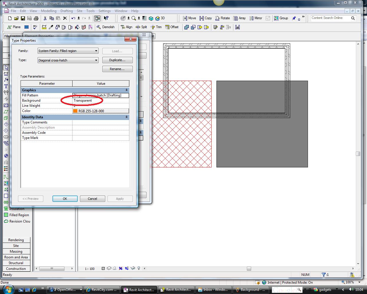

I'm having a problem with filled regions hiding families in Revit Architecture 2009.  I have clicked on the button to send the filled regions to the back, but the families stay hidden.
 Is there a way to send the filled region to the back/bring the families to the front or another way to show a hatched area (eg using hatching to show the extents of a building or the extent of the paved/landscaped areas on site plans)??
 Cheers
Fri, Mar 6, 2009 at 4:07:53 AM | Filled Regions and families
tim123
Joined: Tue, Apr 12, 2005
1310 Posts
4 Stars: 19 Votes
You cannot send filled regions to the back of model objects, but you can make the background transparant.  See image.  For site plans, you can use the tools in Revit to show paved areas ect (topography, floors) rather than drafting them on as you would in cad.  You won't have this problem then.
Sun, Mar 8, 2009 at 7:10:29 PM | Filled Regions and families
vdmmarc
Joined: Wed, Feb 4, 2009
10 Posts
Thanks, that is exactly what I need!
