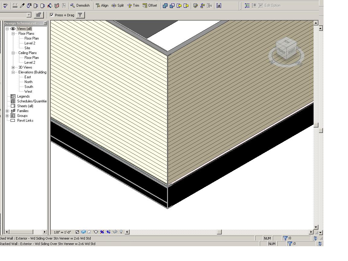

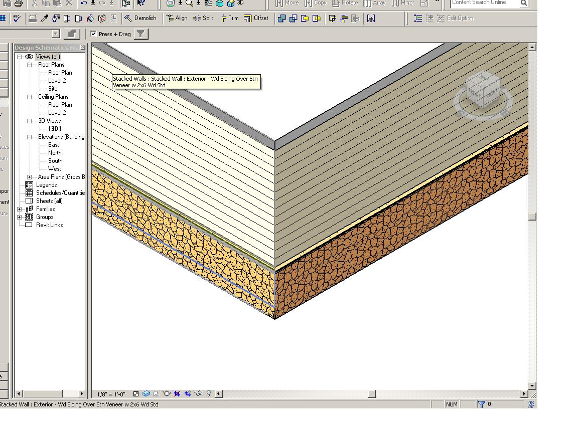

Anyone has an idea why when I copy and paste a stacked wall with stone in the bottom and siding on top to another project looses its properties such as the pattern no longer transfer and the color. See screen shots.
Thank you.

I think that you have the same walls in both projects with different definitions.  Rename the walls before copying, or purge them from the target project first.

Yeah, rename the walls before....

Check the materials, probably, you have the same material in both projectos, whit diferent properties ...
