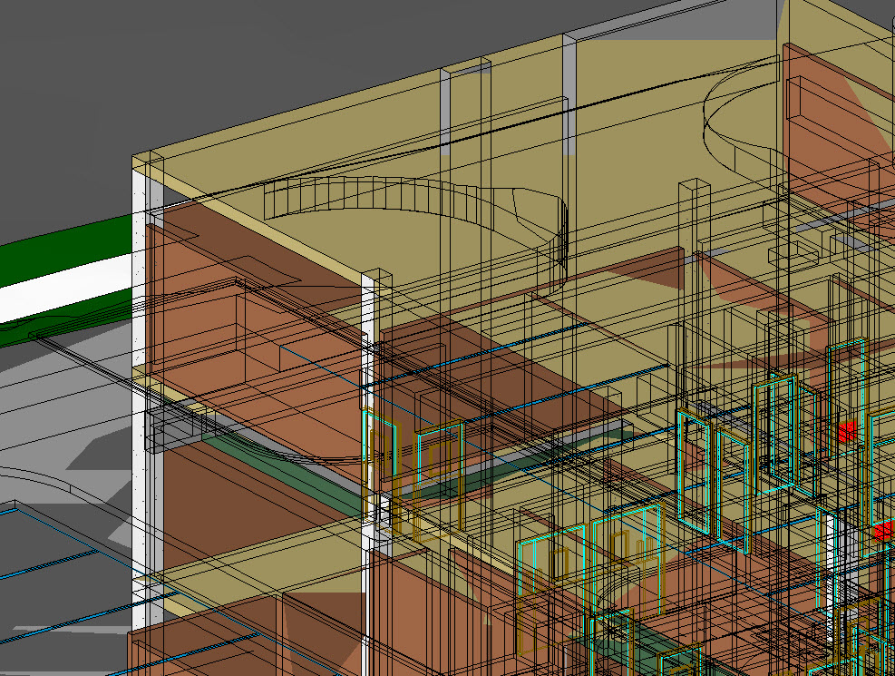

Hi... we have some problem here:  We are in a 4 level project, that's about 70 Mb size... when we need a 3D view isometric, shaded view, we got a color-wireframe.  we can't se anything... (see attachment).  we are working in RAC 2009, in a QuadCore, 1Gb Video Display, 4 Gb RAM.
The problem only comes out in 3D Isometric view, not in a camera view nore any orthographic view.
I had opened the file in RAC 2010 (an alpha version I have), and there is no problem.
¿any Idea?

I HAD THE SAME PROBLEM AND SOMETIMES IT WOULD BE SOLVE IF I HIT THE HOUSE BUTTON NEXT TO THE VIEW CUBE, OR DUPLICATE THE VIEW AND DELETE THE OTHERONE.

Yeah, try deleting that view and create a new one.......

I fixed this issue before, like suggested, by deleting the view and creating another one.
are you using OpenGL? try to change settings for your display. as well, make sure you are on the latest Revit build.
2010 does not use OpenGL...

Manny was correct, there is no need to delete the view and remake it.  Just hit the home button.  Much quicker than deleting and remaking.
