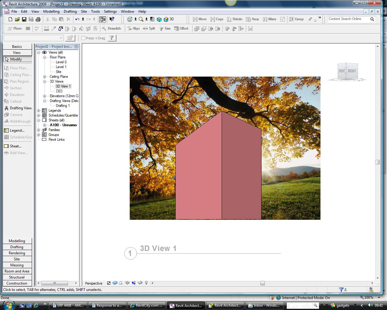

You can do this on a sheet.  Import your image and place it on the sheet.  Insert your 3d view on top.
