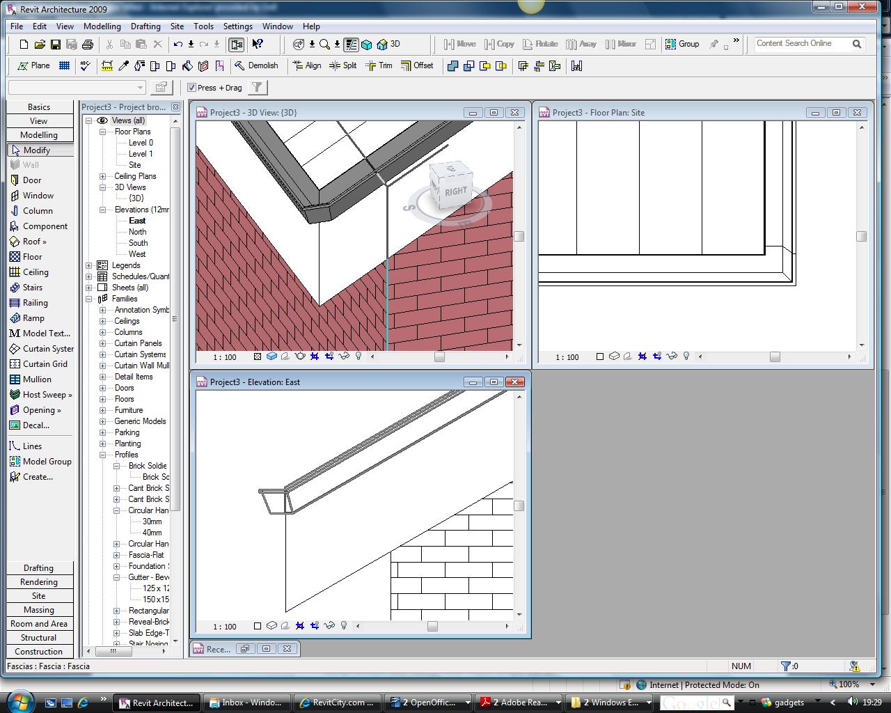

anyway to miter these two...one is a fascia...the other a gutter

Why don't you create that only with Gutter OR only with Fascia???

Your looking at one roof sloping with a cut out....gutter function won't work on fascia side...keeps crapping out...

Well, use the "wall sweep" with that profile...

thanks for suggestion...no go...I need the gutter to follow the slope...1/2" = 1'

Add the sweeps in one go and they should mitre.

 I knew the sweeps would miter...but how do get them to follow the slope of the wall/roof....I am working in 2008 and still no go...

got it....the fascia command will let wrap around and miter...thanks for all you help....

I don't have 2008, but what I did was use the fascia function with a gutter profile as the gutters do not attach to the sloping roof.
