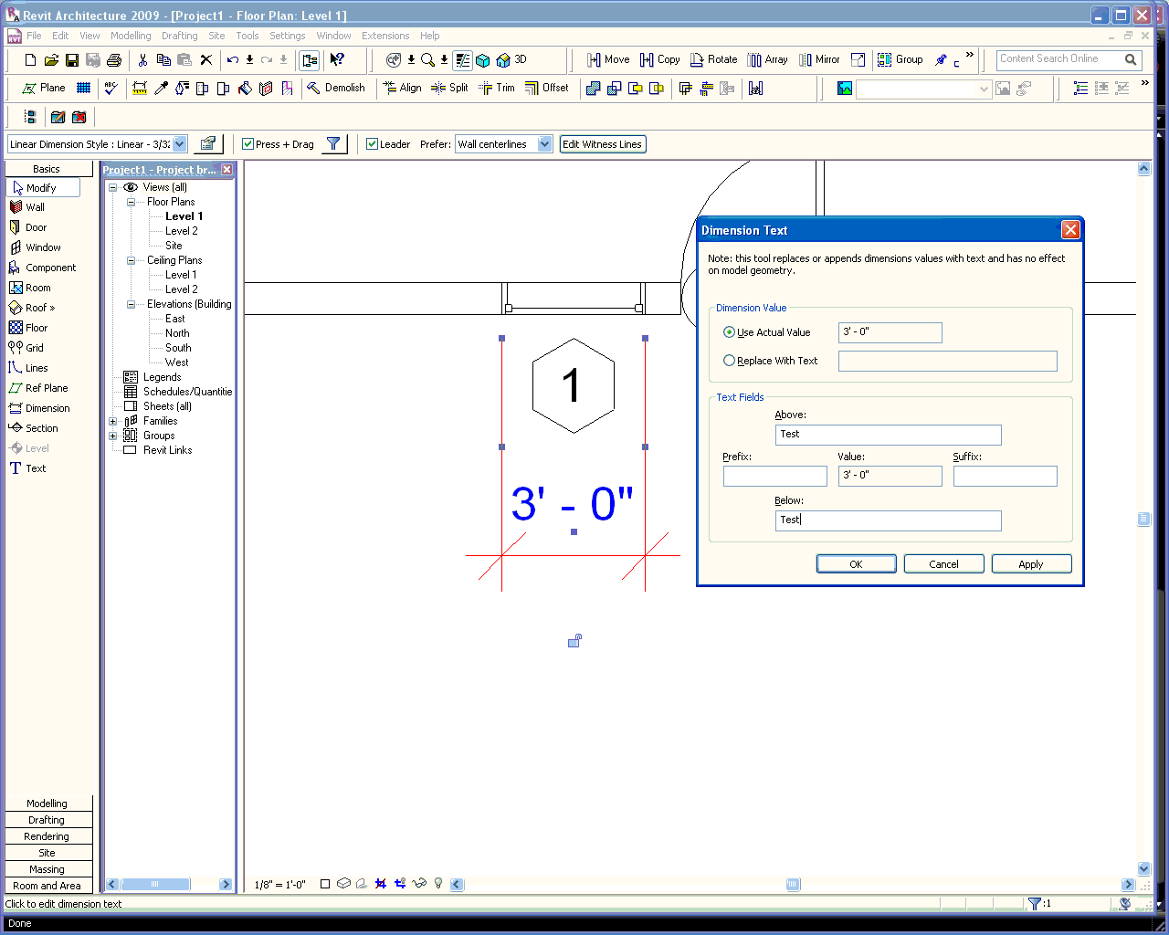

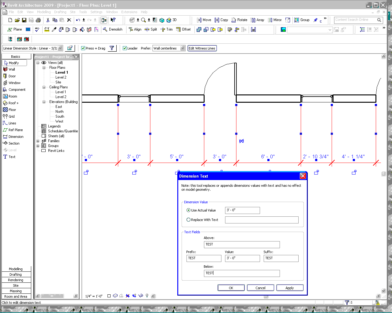

Mon, Mar 30, 2009 at 6:51:24 PM | Inserting text under dimension in string dimension
#9
brettgoodchild
brettgoodchild Avatar
Joined: Sat, Feb 4, 2006
425 Posts
4 Stars: 17 Votes
Here it is; I am able to apply text in any of the locations to all of the dimensions.
I should note that when I place these dimensions I am TAB selecting the walls...being as I'm dimensioning the opening.
I found that if I dimension the actual window or door, then I am not always able to apply the text, but if I TAB select the opening it works.
I apologize for my original post. I should have stated this earlier.
