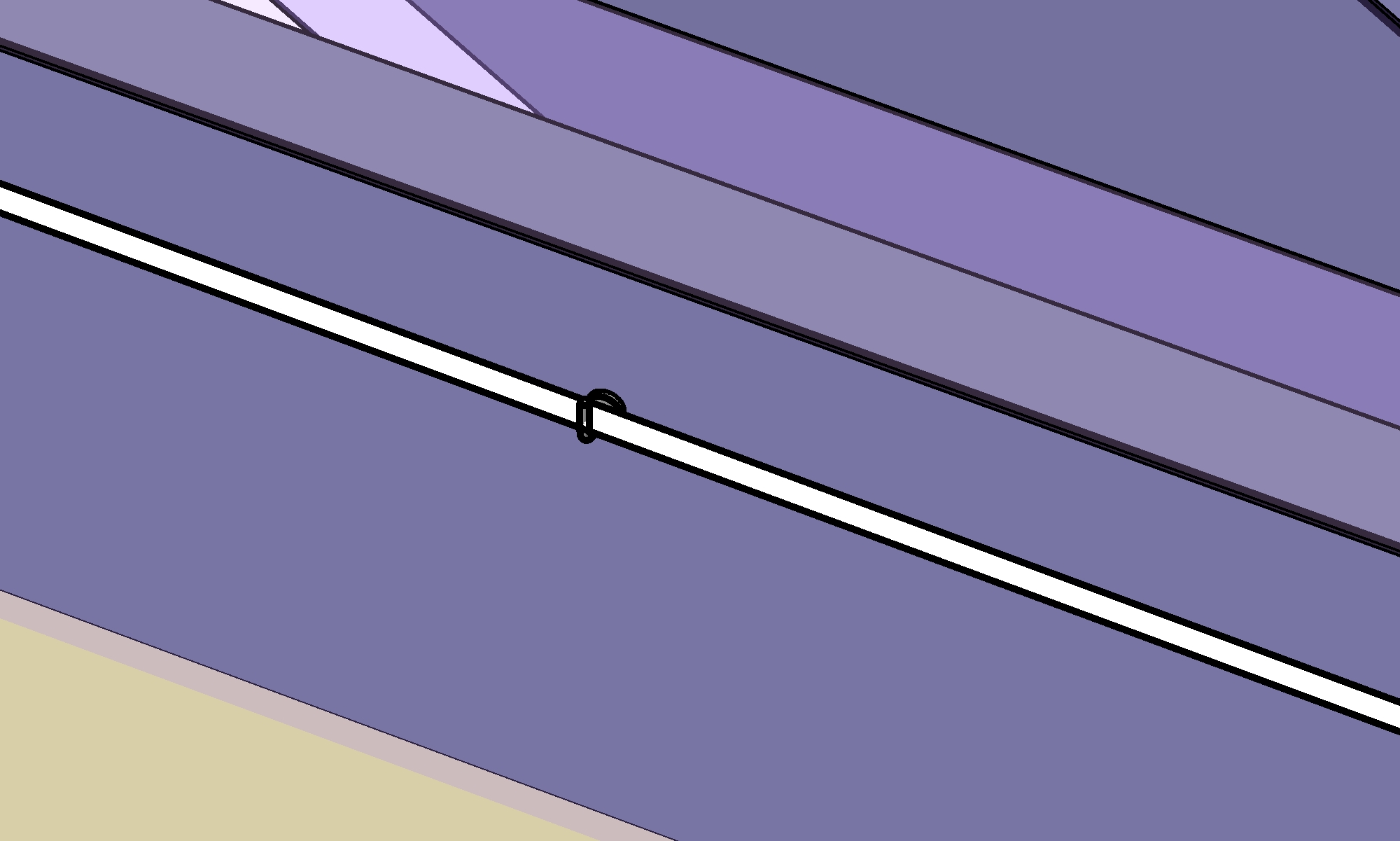

I have a system family which appears to be made up of multiple families in my model on a ramp.
Element Properties: System Family: Railing
Is there any way to find the .rfa and edit it? Where is it located? Can I edit a family within the system family?
I just want to change the bracket length and tube size and then load into project. These are NOT option in the properties.

inside the railing properties go to the balasters and find out whart type it is, then browse through the famlies in the project browser and the edit it
