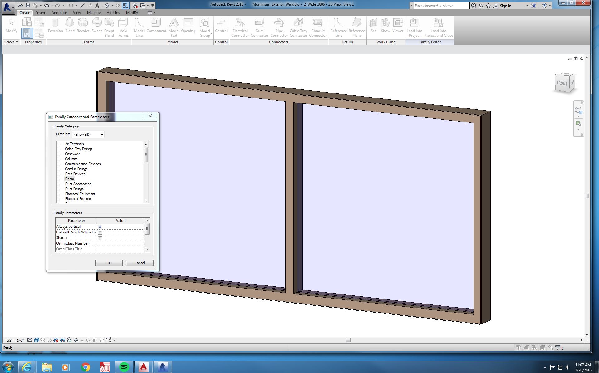

Wed, Jan 20, 2016 at 10:15:28 AM | Combining Door & Window Schedule; it WORKS!
mtsche3
Joined: Mon, Jan 20, 2014
0 Posts
ran into same issue.  I edited the window family (which i downloaded a HM frame window from revitcity) and made it a door type.  The tags are the same as doors and shows up on schedule.
see image
