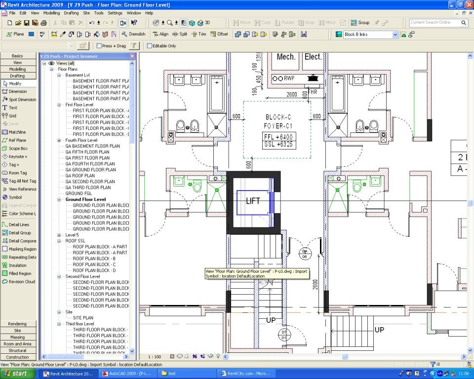

Hi,     1. Can we change the line weights for wall cut pattern (hatch), right now by default its darker......................2. Can we change line weights of tags in family? For example door/window circular tags with line at the centre dividing into 2 half. I want the circle to be thick and the dividing line is to be thin. Any idea how to achieve this in revit architecture 2009 thank you

1.cant we change the pen thickness for wall hatches? as per my company standards in AutoCAD we are using 0.1mm for 100 scale.........how to do in revit?2.As per documentation procedure the actual submission will be on A1 sheet, but we also take A3 size. In auto cad we use different ctb file for a3 and take prints. Now in revit i have kept all my views are in A1 sheet if i take print in A3 everything comes too dark..............any tips to handle this situation? Thank you

hi,   i need my concrete walls/columns should be in grey color solid hatch. i applied solid hatch but its coming as black color in print, so i tried cross hatch with small scale value, though i can able to see the hatches in prints its become blank, may revit don’t accept hatches which are too close!! i dont know. please help me
