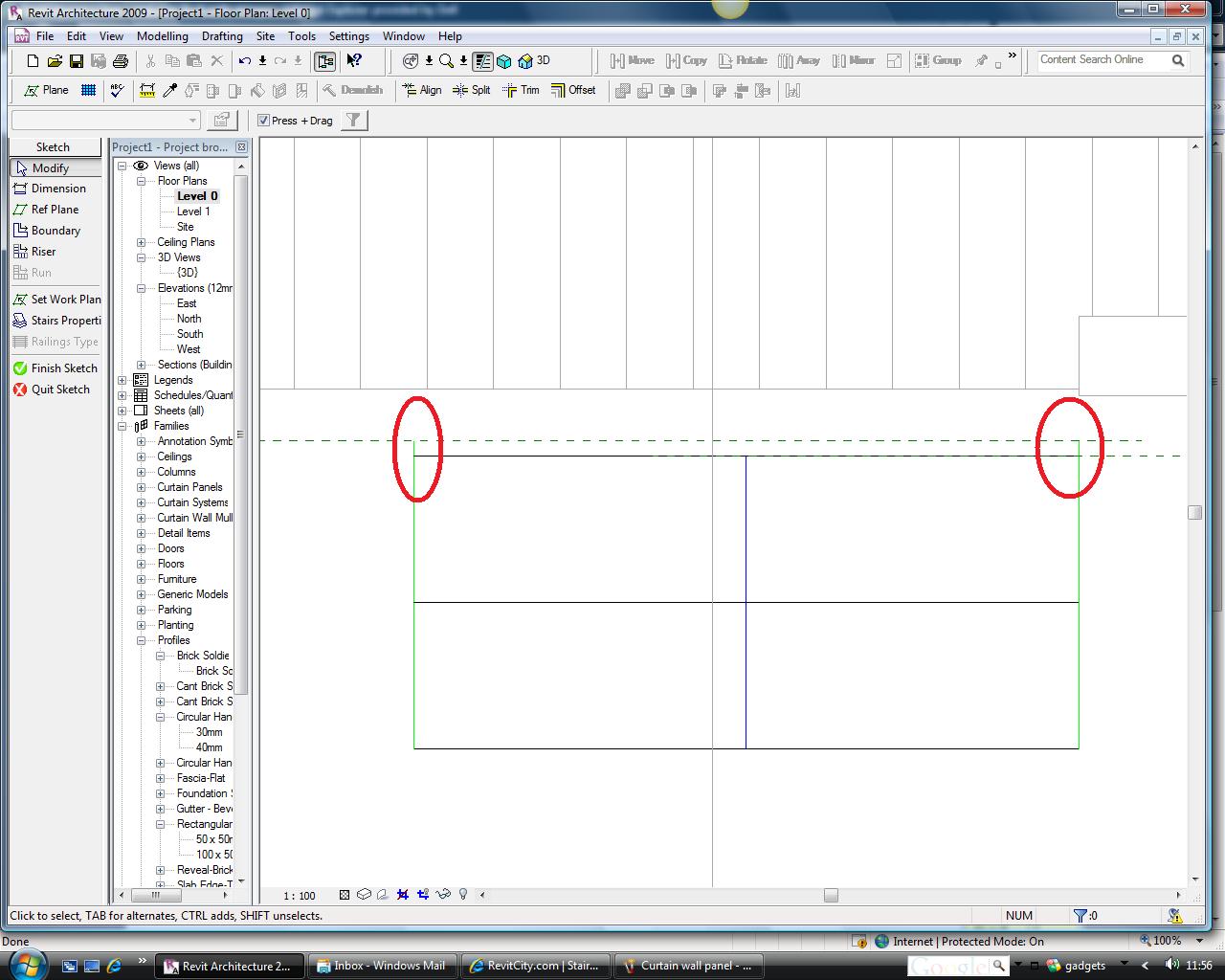

Stair question: I can't seem to figure how to have the stringer and last riser end flush. I want the stringer to extend the back of the last riser so they connect at the landing. Thanks in advance.

Extend the boundary the required amount past the last stair.
