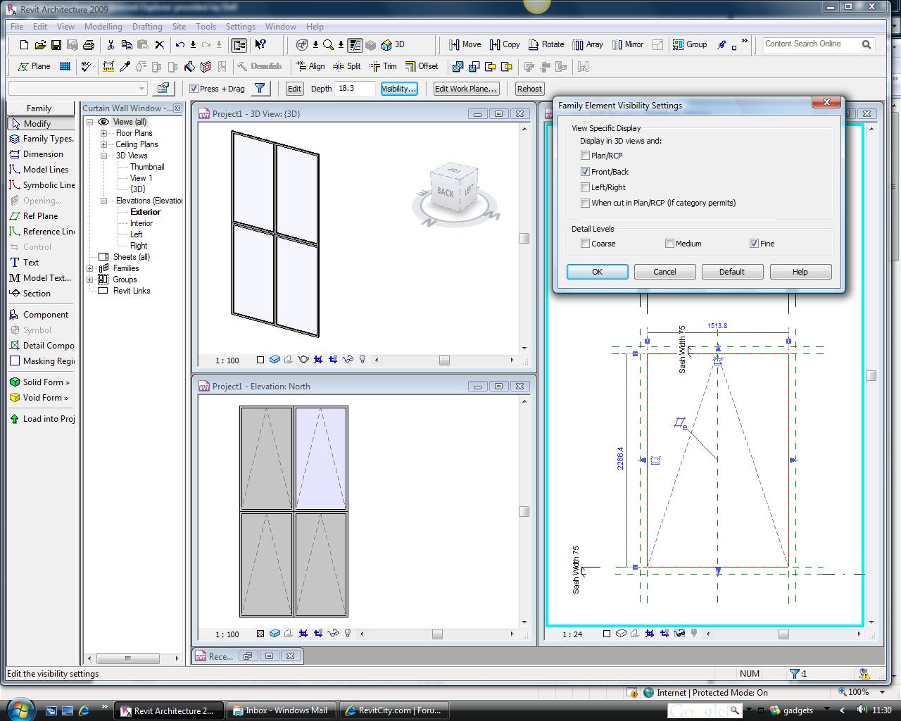

A solution may be to add a second glass pane in front of the existing one in the family editor with a different material and an instance type visibilty parameter.  In the elevations this panel can be set to be visible with the desired display, but switched off in the other views.

OK, sorry this won't work as you intended, but you can get a certain amount of control by adjusting the visibilty settings of the secondry pane, by switching it off in sections, plans, course and medium detail level views.  If you set the 3d views to be course then they won't display.

nice solution tim!
Think that could work well, maybe not this time as i've decided to start breaking up the system so when i start to use IES & GBS to do LEED calculations i believe it will work better.
