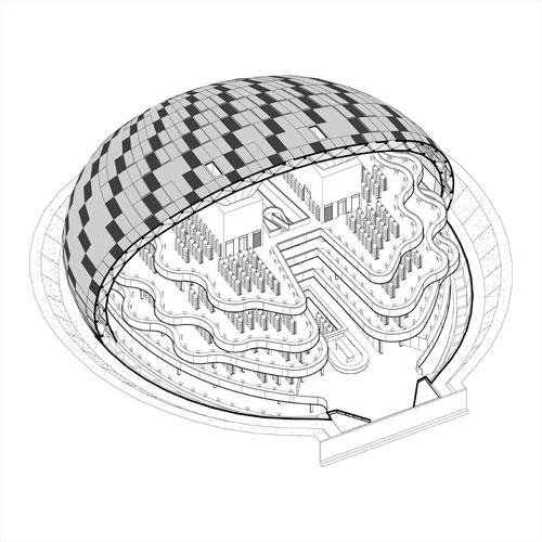

I've created my studio project using a blended sweep, so I have an irregular shaped building envelope. I would like to support that envelope with a truss system a-la free university of berlin (the picture of this is below). The trusses would wrap around this almost spherical building (but an irregular shape). Do you have any suggestions on how I could make those?
Perhaps wrap a railing?

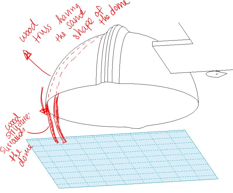

I have the same problem here. What is the solution to this? How can I make the truss having the same shape as the dome? I have attached a picture showing what I wanna do with the truss.
Can anyone help me =)
Thanks.
I tried using the in-place model for the truss which extends down to the floor to support the dome. I have no luck getting it done...
Wed, Oct 27, 2010 at 7:08:08 AM | Curving a Truss to align with a mass
You would have to build a truss family to that shape.  For something as special as this, you can't expect to do it with "stock" items.
Build 1/2 truss in a family with extruded or swepth forms.  I would not try to make it parametric.

If the shape of the roof is more of an elipse instead of dome (maybe like a shape of a boat), then each truss surrounding its perimeters would have different shape of truss right? How do I determine the shape of it? Do I create a specific paramenters or do I have to create the different  shapes of truss to fit the boat shape?
Thanks =)
Thu, Oct 28, 2010 at 6:33:57 AM | Curving a Truss to align with a mass
If each truss is unique, I would build them all in place.  Set a ref-plane (work plane) and cut a section at each location.  Then build your truss from the geometry that shows.
