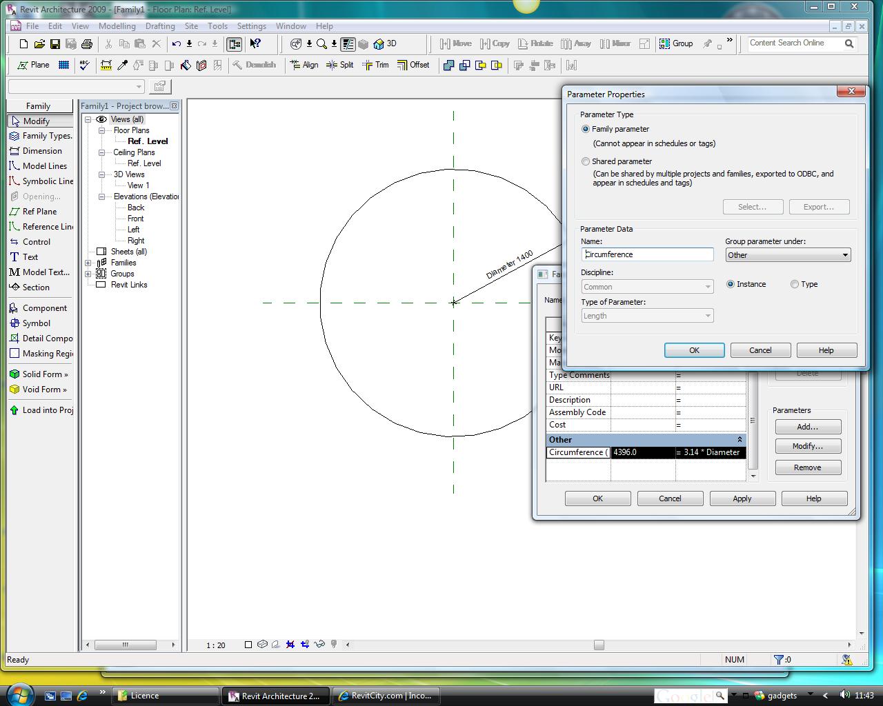

Well trying to get circumference of a circle...pretty easy stuff...I keep getting inconsistent units....
3.14 * diameter and I get that
need a little help...
I really want this to work...some good things some bad

probably you don't have the "Type of parameter" correct !!!

it's length time number....should it be length times length

got it....I played with the parameters....don't understand syntax yet...getting there...thanks for helping meEdited on: Fri, Feb 27, 2009 at 12:40:08 PM

Have you set the circumference as a Length?  It should work.
