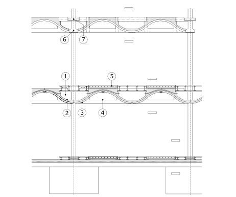

Hi all,
Im trying to create a wave slab like the one in the BRE's office building in the uk, I have attached a diagram to demonstrate what I mean, Im fairly new to revit and struggling, can anyone help please!
Fri, Feb 27, 2009 at 7:32:54 AM | Wave Form slab
ARe we talking Architecture or Structure?
Create this as an in-plcae, extruded floor. Pick a column line for your referece plane and draw your profile there, then extrude in one or both directions.

Structure
How do you mean in place? sorry if this is something i should know but like i say im fairly new to this!?
Fri, Feb 27, 2009 at 8:18:29 AM | Wave Form slab
You can click on componet, and on the options bar, you will see "Create in place"...
But before you do that, you need to spend some time in your HELP understanding families and how you create them.
