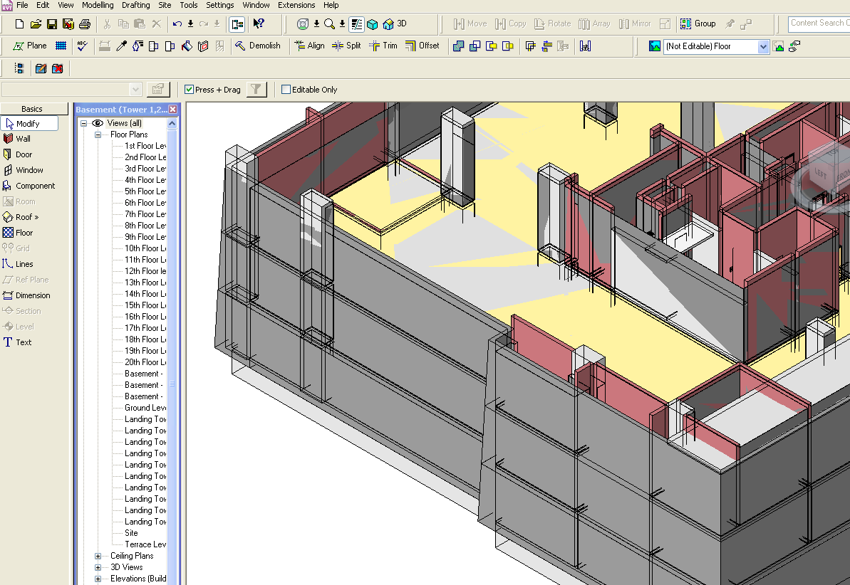

Can someone tell me the reason for the visibility error in 3D view?
See attached snapshot for more details.I have tried all four option - Wireframe, hidded line, shading & shading with edges. Also i dont think its a grahic card issue because rest all the files are OK.
 Please give me some suggestions.

Probably if you install the latest service pack for revit that problem will disappear..
 Someone said that if you chose the home of the viewcube, that will correct the view.
If not, if you erase 3d view, and create a new one, that will solve the problem...

Rams, did you search here for this kind of issue???? because yesterday i awnser one similiar question and i remember there are much more in the forum, try this, in the top menu you have the 3D icon (Blue House) click on it if don't work delete the 3d view and create a new one... by the way, what is your graphic card???

Deleteing the 3d view solve the problem.
Thanks both of you. But any idea - whar can be the reason for this problem?
