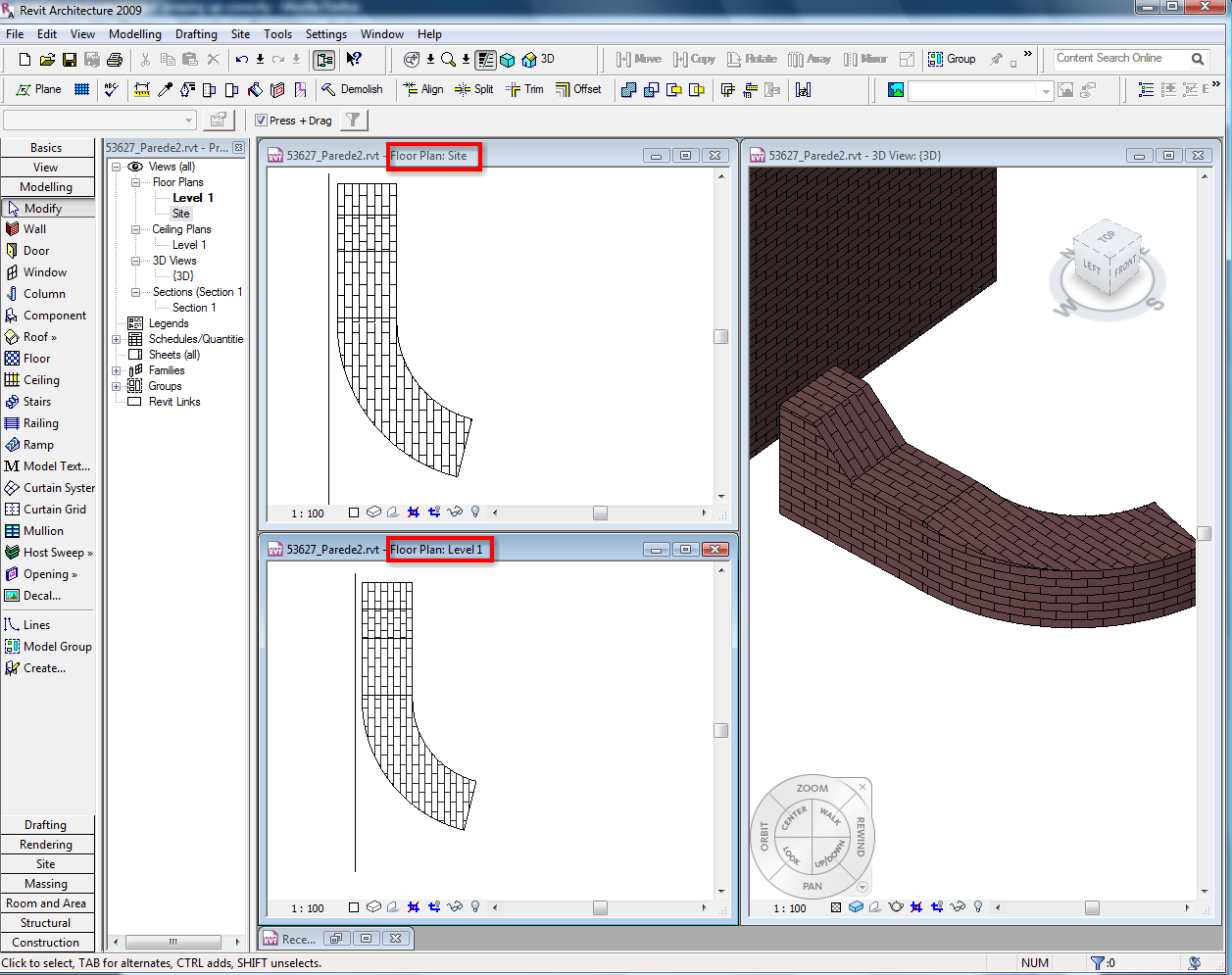

Working in 2008.  The brick wall outside the stairs was made by creating a mass - solid form extrusion - Void form extrusion.  The problem is the brick pattern does not show up in these views as I need them to.  Any help would be greatly appreciated.
Thanks,
Wed, Feb 25, 2009 at 12:35:26 PM | patterns not showing up correctly
Joined: Tue, May 22, 2007
5921 Posts
4 Stars: 205 Votes
Hi raina, check the "View Range", like you can see in the image it's fine...

I am having the same exact problem with my hatch. I think it has something to do with angles.  But I do not know the answer. Did you figure out what the problem is?

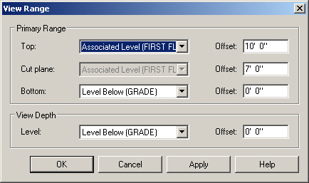

I am not so sure that is it I attached my view range for my first floor plan.  Tell me if there is something I need to set differently.

Try setting the view depth to unlimited...

try changing your cut plane in the view range

I don't think that this has anything to do with the view range.  The stairs below the wall can be seen.

Hi Raina, yeah i did that in 2009 BUT I recreate the model in 2008 and apply the material with the "Paint" tool and it's ok, are you using the "Web Update 3" of Revit????

The paint bucket worked see attached.  I agree I do not believe that it has anything to do with View Range.  For now I will use the work around.  As always I am up for any further suggestions.  Thank you everyone for your help.  This is my very first set of plans using Revit going for permit to the city then construction.  Wish me luck.
