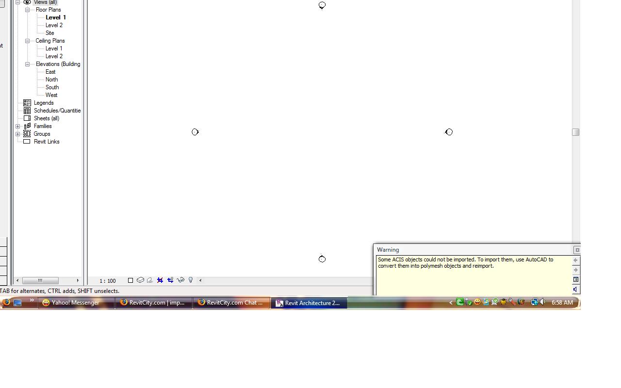

when i import cad format, this error pops and i cant import them in revit, do you know what to do with this?
tnx in advance
