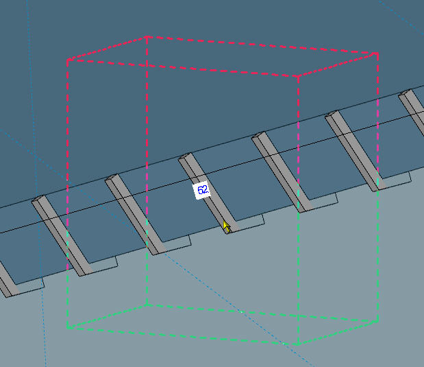

I have created a custom roof fascia that seems to work fine but now want to add a ribbed detail along the face of it.  I can not seem to figure out an efficient way to accomplish this.  (SEE ATTACHED IMAGE)  I have been using a create-in-place family & cutting reference planes for each face.  That works ok except there are a lot of separate faces so it is taking a bit longer than I expected.  I would assume that there is a better way to do this.  I would just use a repeating detail except I need to see this ribbing with shadows in my perspective views. Any help would be appreciated.

Option 1: Create the real thing just on the areas that needs the rendering. Use repeating detail everywhere else.
Option 2: Create a separate face-based family of the rib, add to project, and array.
