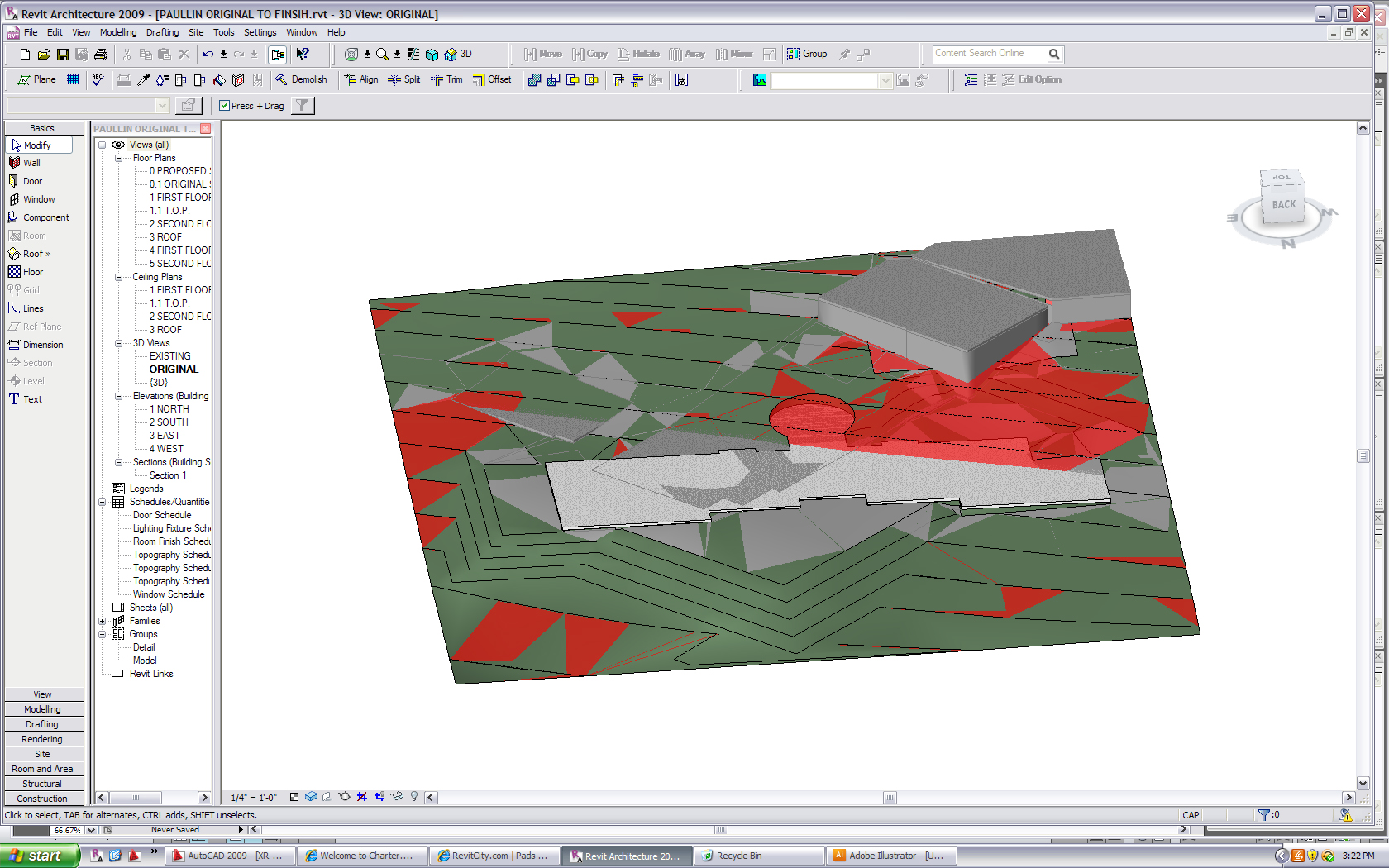

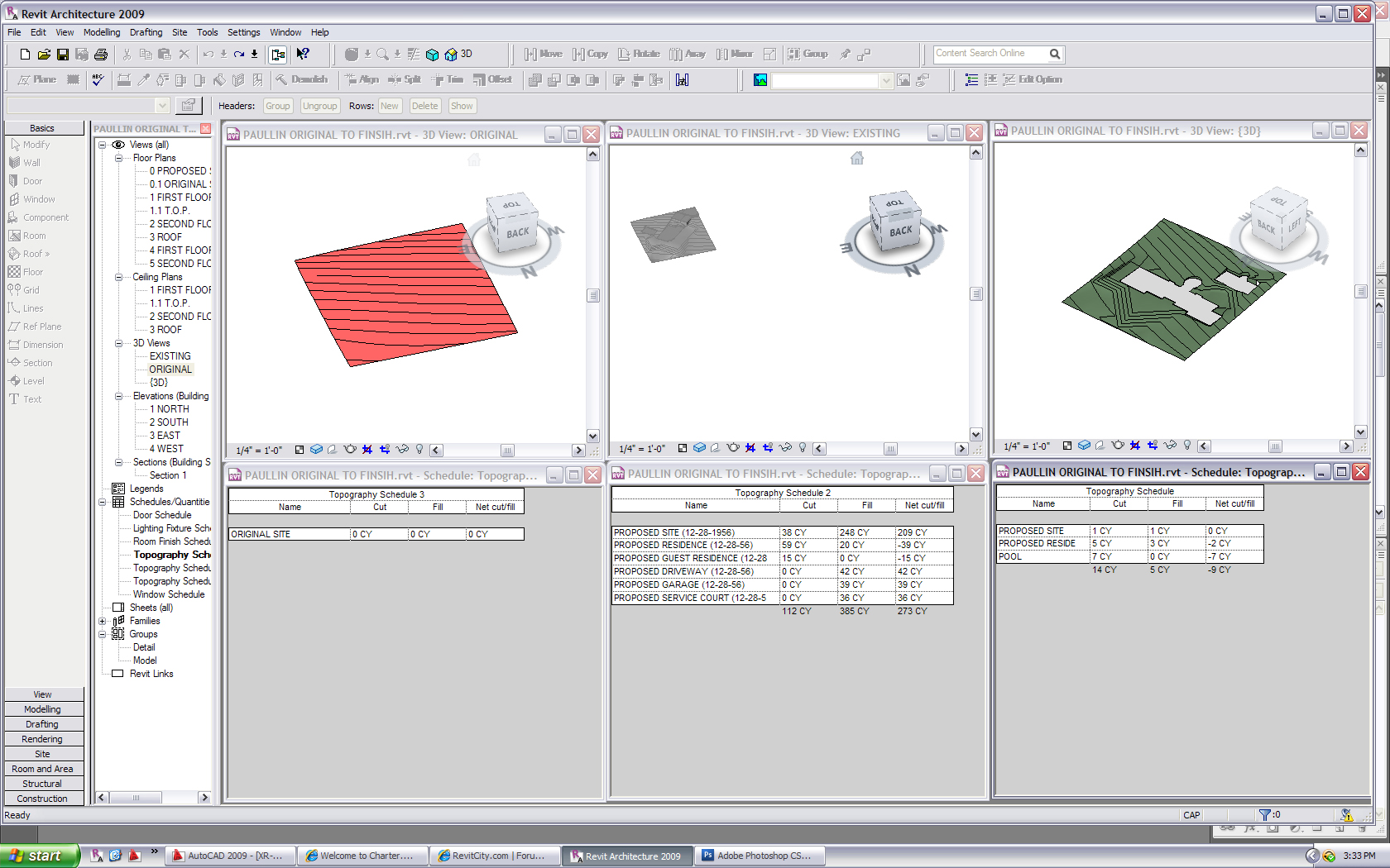

 if you have existing pads and want to demo, set you existing pad to existing phase, then go to site and do grading this is going to demo your existing and create a new topo, and then you create you new pad even on top of your already demo pad.  doing this its also going to allow you to do a cut and fill report on a schedule.  as you will see in the attach image i created an original site, existing site and a proposed site all in the same file, INCLUDING THE CUT AND FILL SCHEDULE

MAY BE SOME PICTURES HELP HA.

MAKE COPIES OF YOUR SITE PLAN AND RENAME THE THE WAY THE I DID IT IN THE IMAGE.  IN THE PROJECT I DID THE IMAGES FROM I CREATED THE EXISTING SITE THE GRADED AND RENEME THEM ONE TO ORIGINAL (NO PADS) THE OTHER EXISTING (WITH EXISTING PAD) ONCE I HAD THIS TWO SITES I GRADED THE EXISTING TOPO TOGETHER WITH THE PAD AND RENAME THE NEW TOPO TO PROPOSED THEN I WENT TO THE VIEW PROPERTIES AND CHANGE THE PHASES WITHOUT CREATING NEW PHASES I USED THE DEFAULT IT WORKS GREAT ORIGINAL TO DEMO ONLY, EXISTING TO PREVIOUS AND THE PROPOSED TO NEW.  POST SOME IMAGES SO I CAN UNDERSTAND WHAT ARE YOU DOING.

In the image that I posted it was just an example of a house that the city wanted to see the very original site before anything was constructed and the existing situation and also the proposed situation.  You don't have to do it three times, now if revit did'nt remove the pad after you grade it would not let you put your new pad over the old one, know doing this its also going to calculate the cut and fill for you that why I posted all this images.  Practice and you will see that it really makes sence.
