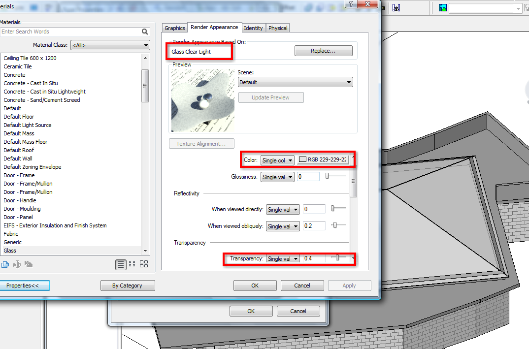

Did you try "Glass Clear Light" and change th color and transparency???

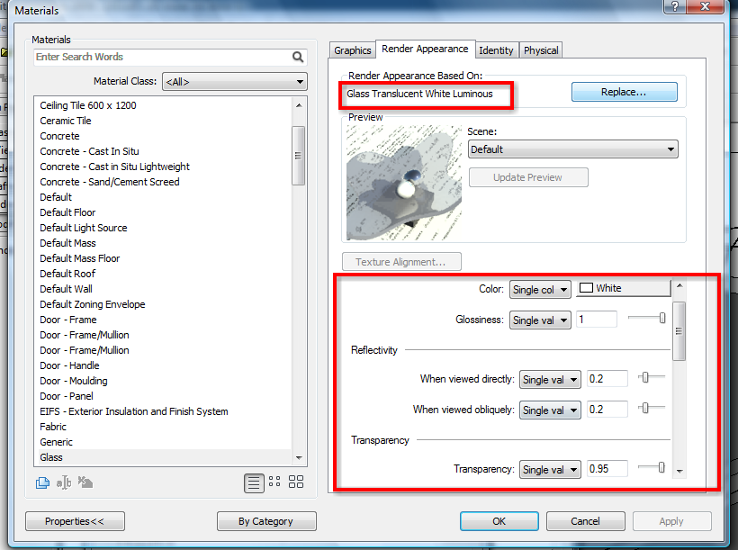

Like this????

Yeah, that's just what I'm looking for.  I would really appreciate it if you posted up your exact material settings, a screen shot would be great!
thanks mate1

That it is...
