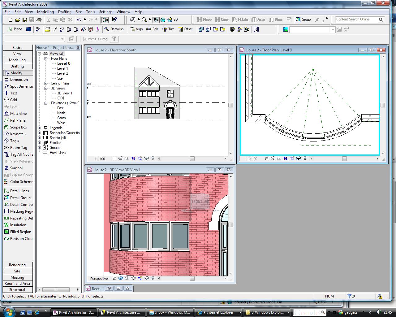

For my first family I would like to build a five element bay window with the elements arranged around a semi circular path.... I feel this is probably over ambitious but...
How should I constrain the path of the 5 windows?  If I simply have 5 segments and make then EQ then as the opening width changes I might get a problem since EQ is easy to meet as a constraint but the angular relationship need not be maintained.
I think I need to impose some kind of angular constraint?   Any examples of distributing 5 elements around an arc?

You might consider using a curtain wall instead of a window family to create this using a circular array of reference planes.  The curtain wall grid lines snap to the ref planes and you can create the effect of a bay window.

Thanks for the curtain wall suggestion; I think I will follow that avenue.
 I have given up (at least temporarily) on the 5 element curved bay window family as I'm not convinced the geometry can be expressed as a closed form.... i.e. solution for the angles from opening width and bay projection requires an iterative solution.... but I may be wrong.
