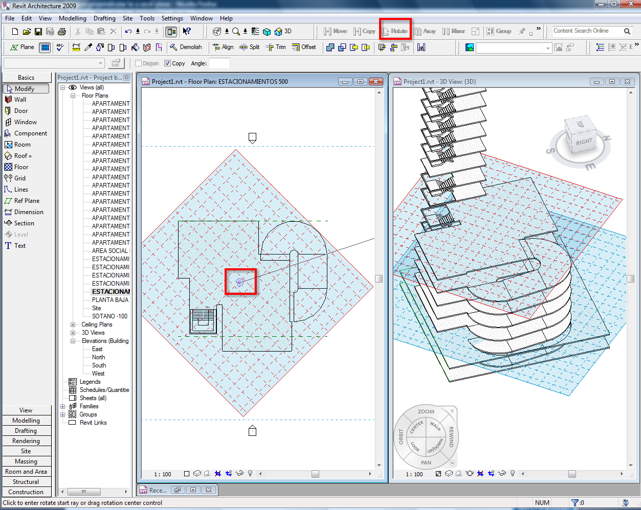

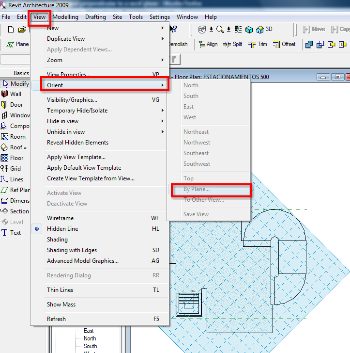

I am trying to orient plan view parallel to working plane but the view>orient> shows only grey out options. Am I missing something?

On this same topic...  I was wondering if there is a way to "Orient to other side of plane"  Revit is going to a perpendicular view, but it's not looking from the side we want to be on.....  Do planes have side names?

It will orientate to the side that its closest to at the time.  Manually rotate the view around to the other side then orient again...
