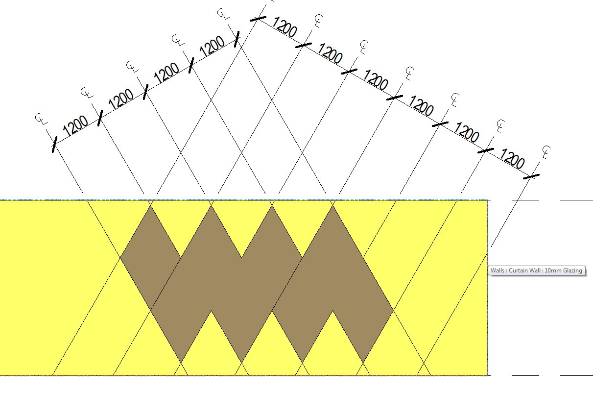

Is there a way to rotate a single horizontal mullion in elevation?  So if the vertical mullions are vertical but the horizontal mullions are not horizontal but forming something of a zigzag pattern?  Racking my brain . . .

Like what??? pictures please, also in the properties of the mullion you have the "Angle" parameter to rotate that mullion but i don't know if thisi is what you want...

Basically a pattern in elevation that looks something like Charlie Brown's t-shirt.  Just imagine vertical mullions at the peaks and/or valleys.

Like this????

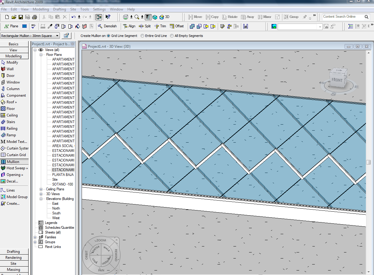

Not quite but that's further than I've gotten.  Like that but without the breaks in the glass above and below.  Vertical mullions above and below.  So how did you do that?  I can figure out angle in one direction but how did you angle in both directions?  And then above and below, are those different types of mullions or did you erase mullions?

Yes just use the angle parameters for vertical & horizontal grids and adjust as necessary.  I set mine to 60 & 30°.  Then use add/remove individual grid segments to get rid of the lines where they are not needed.  Unfortunately it will want to break it up occassionally still...
