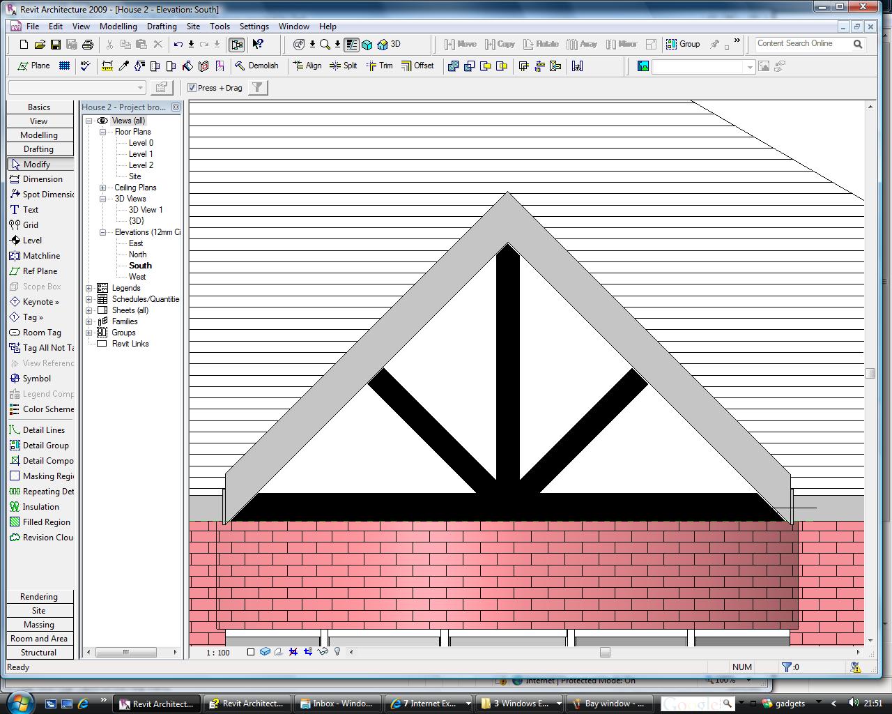

I would like to add Wooden Elements to the exterior walls to show the neo-tudor detail.
What is the best approach?  Should I just create mass elements and make them look wooden?
There is lots of such detail on both the walls and the dormer ends.

you might be able to create another thin wall say 2" over the, I am assuming stucco wall, thin trim out hole in the wall editor.

or maybe a wall with wood as a layer and articulate it?

You can create an in-place family and extrude it from the wall.
timber and steel to have different detail levels
