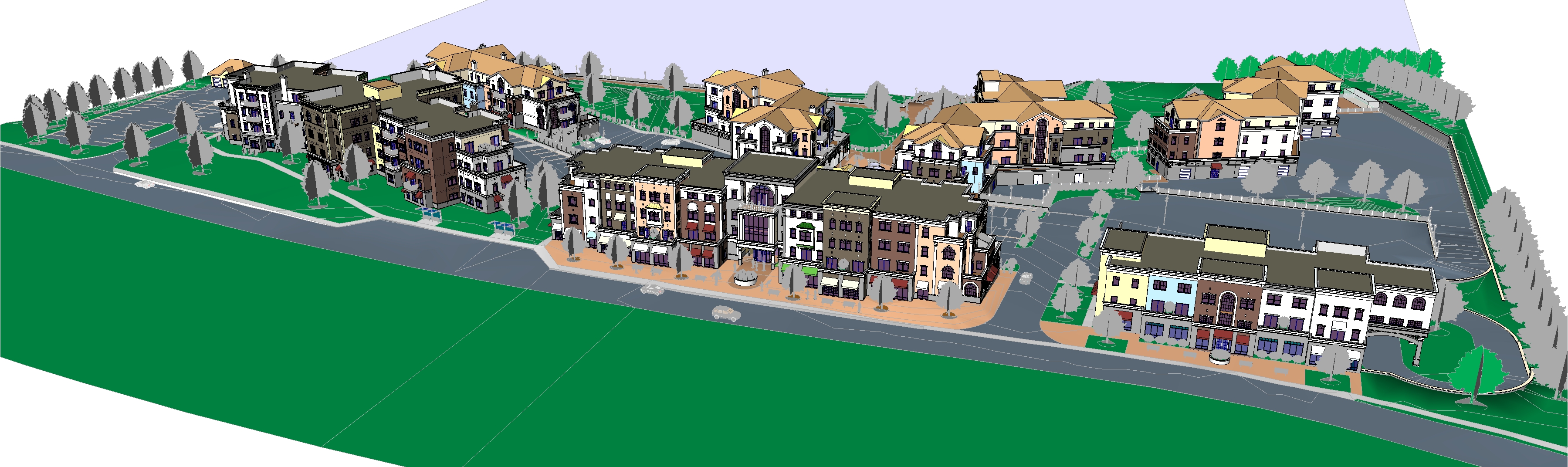

I am trying to render a 100 mb revit file and I cannot render any view larger than 14" 150 dpi.
I have a dual processor w/ 3.5 gb ram and a 75 gb hard drive.
Do I need a better computer or is there something that can be done in Revit Architecture 2009?
The model itself covers a 10 acre site w/ 7 buildings approx 16,000 sf each & 4 stories.
I have seen some large detailed model renderings on this site in the gallary so I know it can be done.
Any help would be appreciated.  Thanks in advance.
