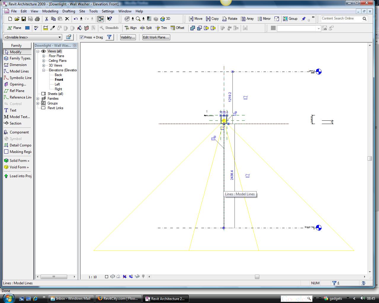

How can I show lighting fixtures on a floor plan at the same time as electrical receptacles, swithing and wiring between the two.  light fixtures do not show up on floor plan views. I have tried editing the light fixture components to be visible in floor plan view but nothing seems to work

Draw an invisible line to the ground in the family.  The fixtures will then be visible.
