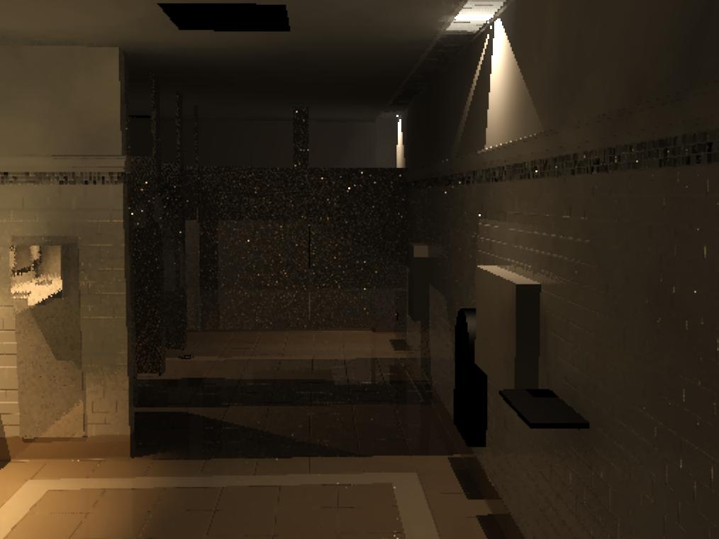

I am having similar problems. I have a linear light source but when I do the render it shows it as coming from a single point. I attached a pick of the rendering. Any ideas on how to correct this problem?

YoKanski
It is hard to tell without seeing the fixture, but one possibility is that the light source definition in the fixture family is set to the incorrect type.  Try opening the fixture in the family editor, selecting the light source, and checking the source definition.

It is Currently a linear light source. Is there another type it should be?

 Found a slolution to this on AutoDesk's Site. Click Here or see below.
  1. In the Rendering dialog box, select Edit from the Settings drop-down menu.
  2. Select the Enable Soft Shadows dialog box.
Mon, Mar 9, 2009 at 8:17:17 PM | Cove lighting
iREV
Joined: Thu, Jun 8, 2006
72 Posts
3.5 Stars: 3 Votes
chose to use a photometric web when the light source is selected. Next, go to the family properties and then to photometry change the emit box to the correct dimension and make sure that show emit light box is checked.  Also, what version of Revit are you using '09 or an earlier version? This will greatly effect your light renderings as there is a new rendering engine (mental ray WAY better than accurender) in 2009.
