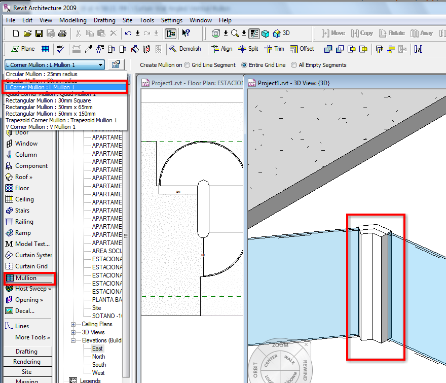

I am creating a model for rendering purposes and am having trouble getting the corner of a 45 degree curtainwall to miter (see photo).  The rendering will be looking at the outer corner which is where the whole problem is.  Does Revit contain this power or am I better off putting a mass in their as a "fudged" fix.

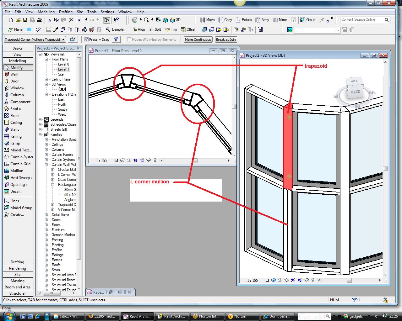

I think you will have to put in a seperate mullion corner... your own family - not a curtainwall element.

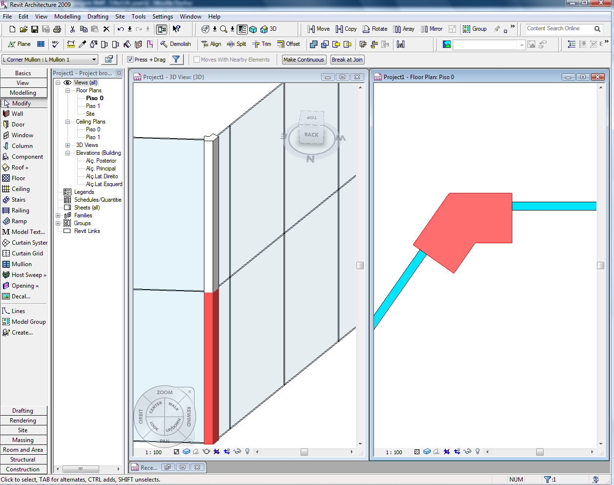

Typhoon...that looks like what I need.  I do not have a family that resembles that and have been unsucessfull in finding the way to create such.  Can you point me in the direction of the custom family fabrication?

Like you can see in the attached image you have that in you revit "L Corner Mullion" - use that in that corner...

Or as trapazoid.

wow...quite simple when done correctly.  Thanks for the help!
