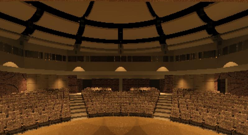

I have seen threads about light sources (actual light coming out of the fixture) not rendering in recessed can light families becasue of ceiling etc, but has anyone had issues with it on standard hanging pendant lights? When I render the light is cast onto the objects in the room but the light fixtures remain black, as you can imagine, it looks a bit carzy silly with random light casting onto objects with no light source in sight!
I've a attached a quick render for reference
 Note: The pendant lights are between the clouds
Thanks!

I usually make part of the light family a bulb.. I assign a material "bulb" that makes it look it is giving off the light. I think it is under Glass materials.
