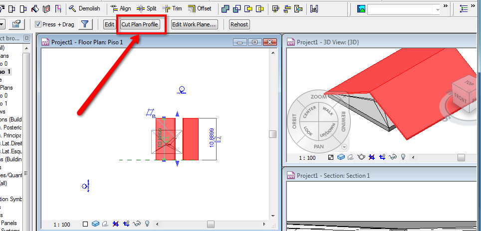

You can't Join those roofs because they don't intersect totally, that's the problem, what you can do it's in Plan view, select that roof and in the "Option Bar" you have the tool "Cut Profile", use it....

Yes you have, Like you said "Currently all roofs are drawn by extrusion." so...
But the problem you post in the image it's because you don't have the top of the two roofs in the same height, that's why you can't join...
