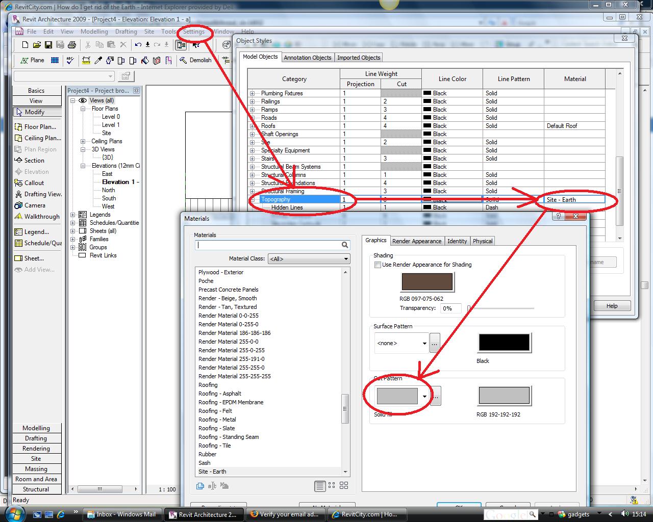

Fri, Feb 13, 2009 at 9:22:10 AM | How do I get rid of the Earth
tim123
Joined: Tue, Apr 12, 2005
1310 Posts
4 Stars: 19 Votes
Or you can set the display settings in the object styles.
This will only affect your project though.  More drastic measures would be required to get rid of the earth.
