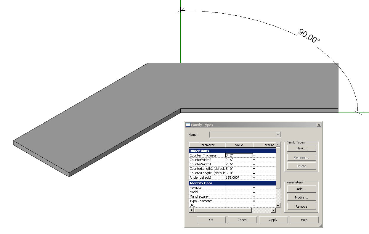

I cannot figure out how to get the countertop (see attached file) to adjust so that it can go from being a 90 degree angle to a 60, 45, 30 etc..
The object to rotate seems to require nesting or group to work with an angle parameter.  The crux i find is that in order to nest or group the object it is then forced into a fixed form.  That defeats the purpose of it being able to stretch to accomodate a new angle.  Has anyone ever attempted this type of a family.  It seems like its impossible for the object to stretch to a new position and apply angle parameters.
Like to see feedback on this, at this point i cannot logically find a way to do this.

Are you looking for something like this? See attached.

Yes thank you.
