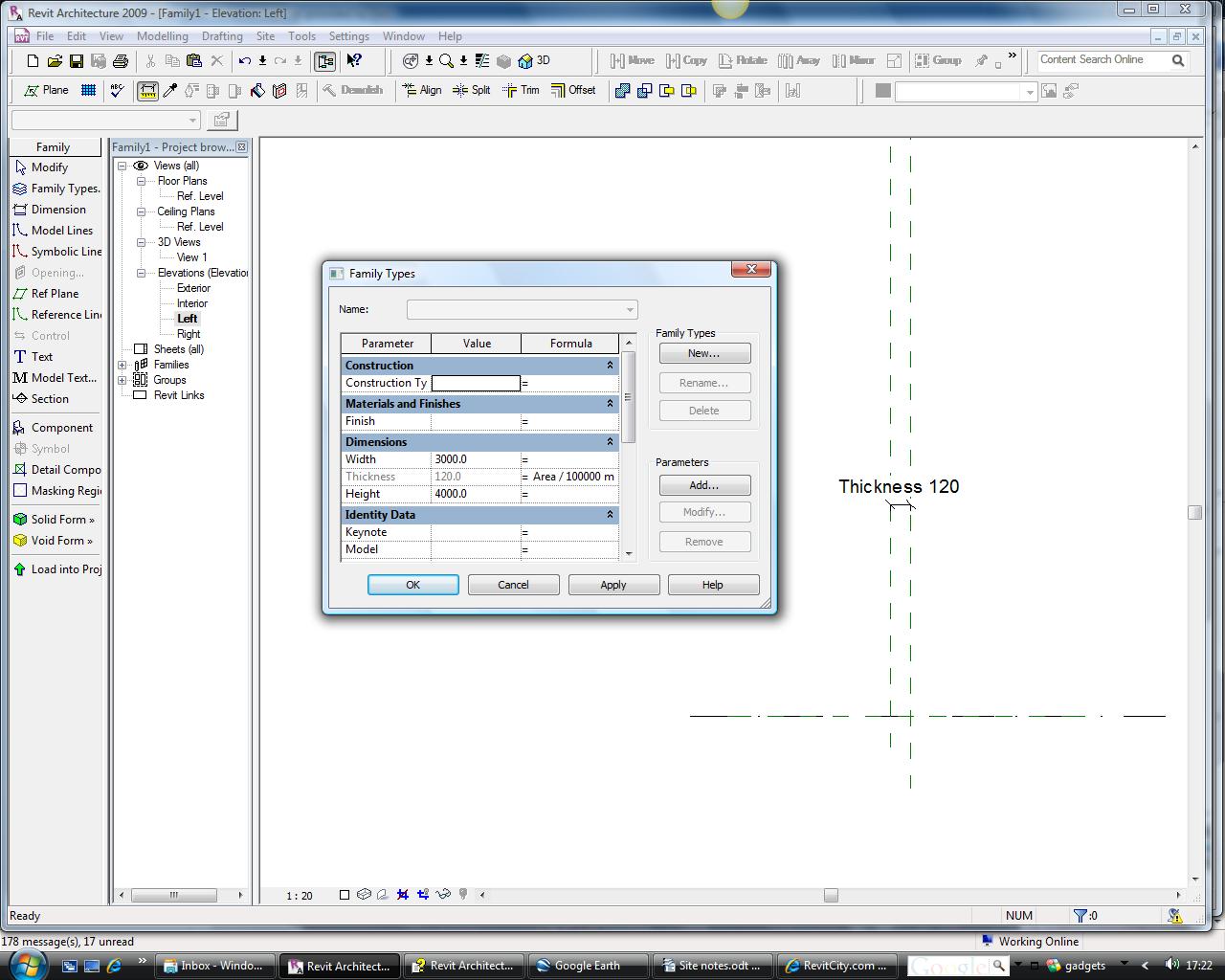

I have to create a parameter for a curtain wall. I want the thickness of the glass in the pannels to change proportionally to the area of the wall any ideas?

Create parameters called thickness, length, width and area.  Apply a formula to area using height x width.  Apply a formaula to thickness called area / required factor.  The thickness will adjust according to the area.
Glass generally comes in specific thicknesses though, so you may have to create an additional formula to show specific thicknesses.
