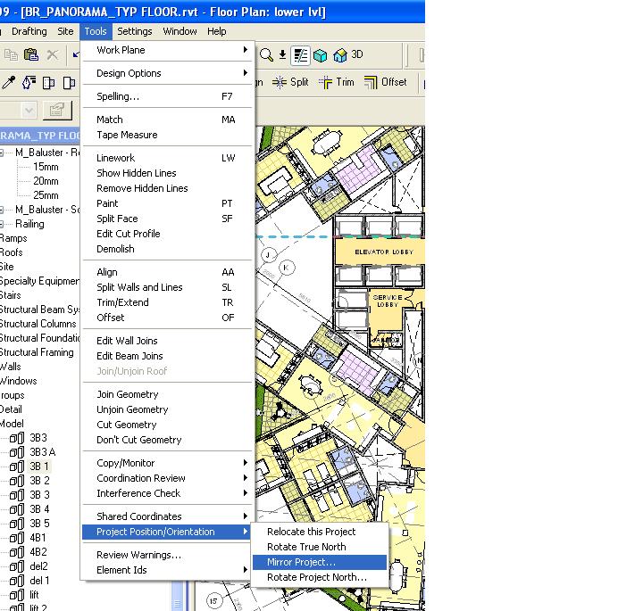

Thu, Feb 12, 2009 at 6:08:27 AM | MIRROR entire HOUSE
Sandarch
Joined: Tue, Sep 4, 2007
6 Posts
If you are using Revit 2009, you have a tool to mirror the project.
I have attached an image, just see it.

Thu, Feb 12, 2009 at 6:23:19 AM | MIRROR entire HOUSE
2005Mark
Joined: Thu, Sep 15, 2005
36 Posts
3.5 Stars: 2 Votes
Thats brilliant. I have always gone down to alter the Project/True North and never noticed mirror project tab next to it. Thanks to all.
