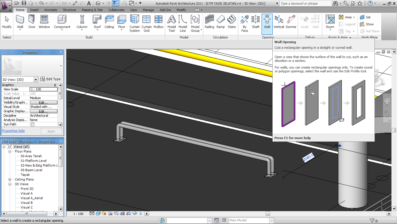

In Revit Architecture 2011, you can also use 'Wall Opening'. Select any wall, and create the opening you disired. Adjust the dimensions and it's all done.

I'd suggest using a wall opening.  they handle joins intelliegently, are flexible to use without going into a sketch mode, and you can select them and enter exact dimensions through the properties bar.  For rectangles, this is the way.  for complex shapes, edit profile.   For curved walls, openings are also the way to go.
