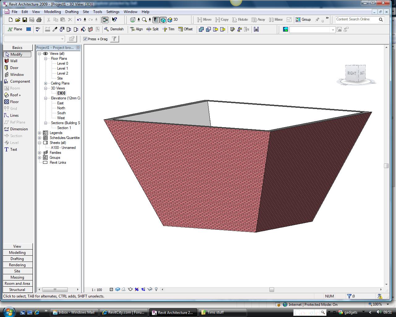

One way is to create a mass and apply wall finishes to the surfaces.  You can then delete the mass.  See image.

hi guys i really need help biig time i cannot slant any of my walls on revit,i am new to revit architecture and am working on a project which requires slanted walls, i have tried creating mass and sweep blends and everything but it keeps on giving me an error i would request for a detailed procedure into creating one it would be of great help and its quite urgent.....

hi i managed to slant the walls it was a great progress thanks but now i am stuck with the mass not takin in any material, i want this wall i have created to be a curtain wall how can i do this please let me know, i also have another question i am designing an auditorium so it has that theatre like seating so all the seats are on a diff level goin down something liek what when we go to the cinema i wanted tro create this please advice and thanking you...
