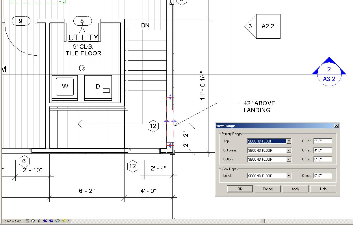

Hello,
Working in 2008 and having a prolbem with plan region and getting a window to show up.  See attached floor plan with plan region and the elevation.  What do I set the view range to on the plan region to get window to show up in second floor plan.  It is currently set with the
top: second fl. 9'
cut: second fl. 4'
bottom: second fl. 0'
level: second fl. 0'
These are the current view range settings however it seems no mater what i change it to it will not show up.  Does anyone have a answer?  View ranges are driving me crazy.
Thanks everyone.
Mon, Feb 9, 2009 at 4:03:11 PM | plan region/view range window
Turn on your plan region in plan so that we can see that & pull up your plan region's properties ... then do a screen shot of that ... better than pdf's.  Might look at screenhunter - it's free.
